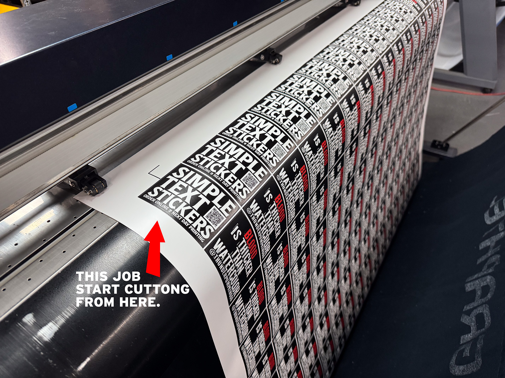

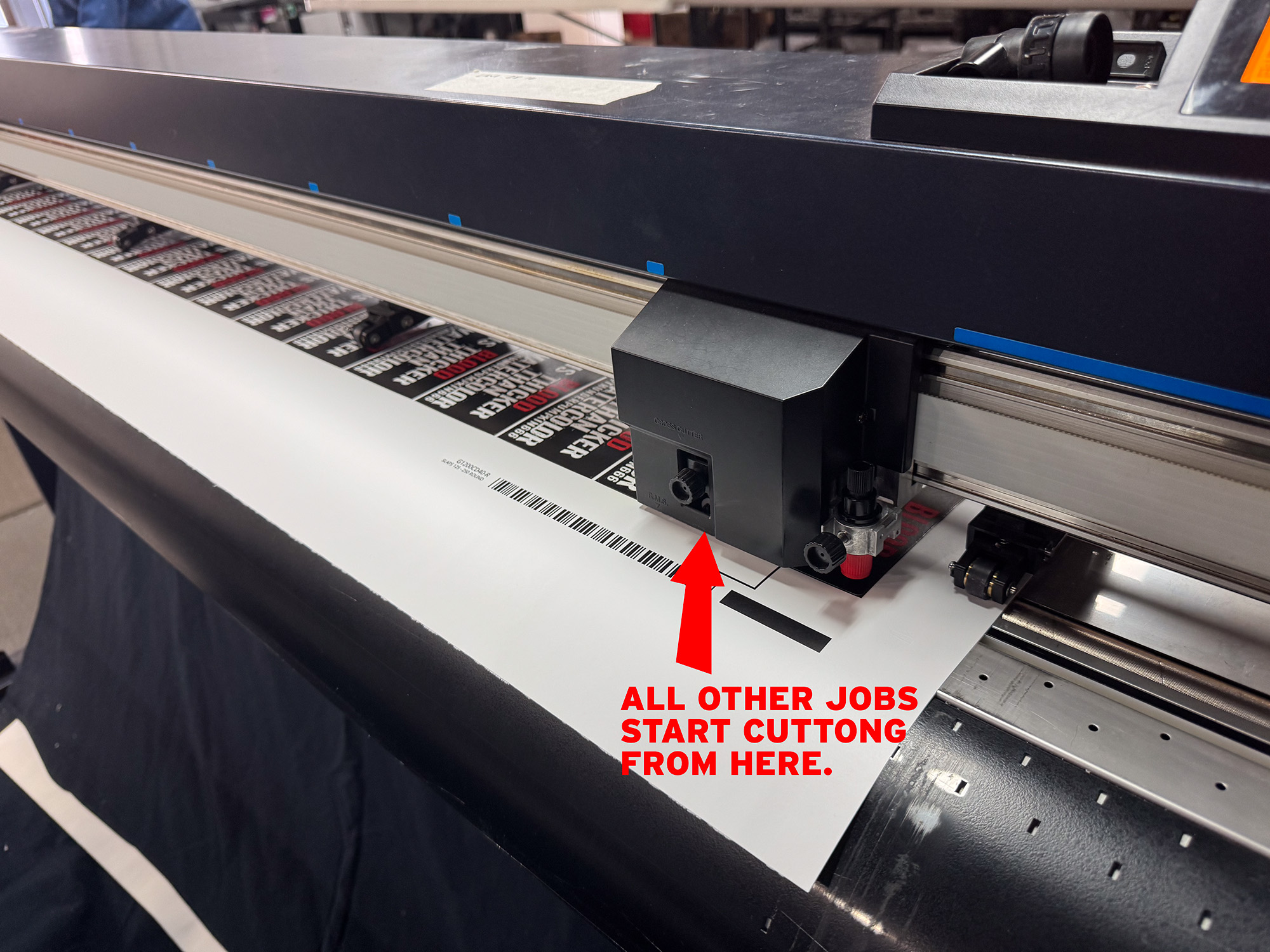

Hey, Everyone. I'm having a hard time figuring something out. For all of our sticker jobs, we set up the sheets in Illustrator and use Cutmaster to create barcodes and cut marks. We rip from Versaworks and cut from the .xpf file on thumb drives. All of the sticker jobs start cutting from the first row that is closest to the cut head, then work its way to the back except on kind of sticker. This typle of sticker isn't anything special—4x3 rectange—but for this one, it reads all the marks, then it starts cutting from the back. Is there some setting I'm missing that tells the cutter what order to cut the stickers in? I've attached a couple of phots in case I'm explaining this poorly. I've been having trouble finding information on this—I'm assuming it is likely becuase I'm not sure what to search for. Any help would be greatly apprecaited!

IIRC cutmaster goes in order that the lines are ordered in the illustrator file. I don't remember if it's top to bottom or vice versa, but perhaps look at the layering and see if it's the same as others or possible it's reversed. Hope that helps.
