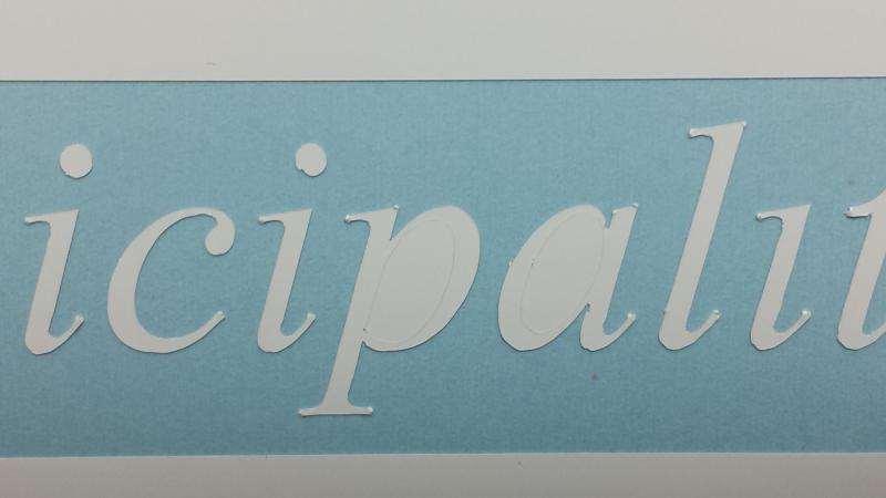

I've attached a pic so you can see what's happening. Thanks again

Looks like the blade is not swiveling freely. Take the blade out completely and check that there is no dust or anything restricting the bearings in the inside of the knife holder.
gabagoo
On my Graphtec I can open the blade holder up and grease the bearings inside. It could be that it is not turning 100%... (white grease)

I actually have already done this. I figured the same thing so I grease the parts in the blade holder. Seems good and seems to swivel properly.
I did find out a bit more info from one of my employees however. After I changed the cutting strip, they kept the pressure at the same as it was before and it had cut completely through and they failed to notice it till the cut was finished. Unfortunately the cutting job utilized the full length of the strip. After they mentioned this I can see visible cuts in the strip running the length of it. I'm wondering if this is the issue??

If the blade is swiveling freely, then you might have too much of the blade tip sticking out. If you do, then it can sometimes cause the blade to not swivel as quickly or easily as it should. It can cause start point/stop point from not meeting as well as booger up really small and tight corners. Can you show a pic of how far out your blade is sticking?
