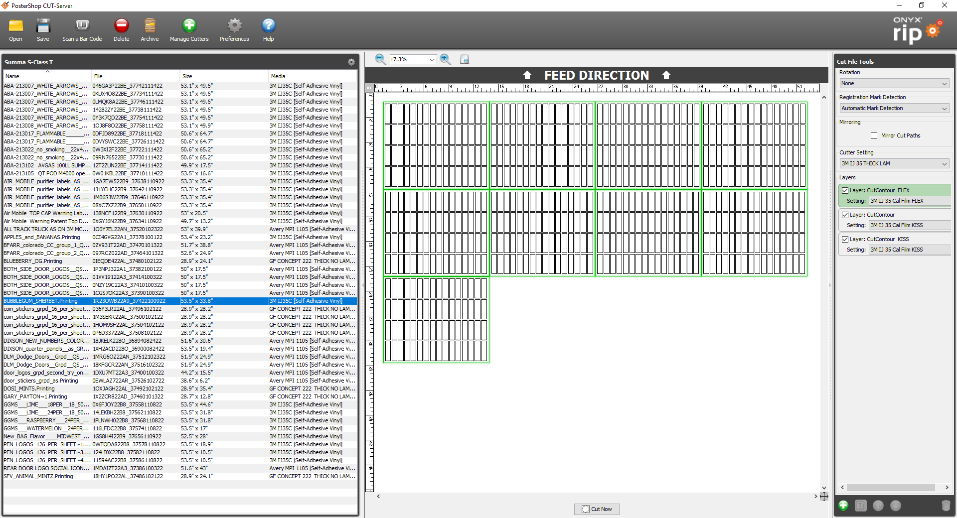

If you setup the Summa and use Onyx, then you will setup all of your cutting preferences in Onyx CUT-Server, then in One Job, you will setup and designate both the Kiss and the Flex cuts and send both at once to the plotter. The Summa will always first cut the Kiss info, then cut the Flex info, regardless of the "Cut Layer Order" shown in CUT-Server.
Once its done, the plotter will advance and "read" the next barcode. Then you need to note that code, find it in CUT-Server and send the next file.
To truly use the Summa to run a whole roll you will NEED the added Take Up Reel attachment on the Summa.
Without it, you will have to do a Page Cut at the plotter after its finished a job, then redo the OPOS alignment again to the barcode that it just automatically read. Then send the next print files cut info..........

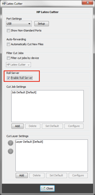

But I imagine I would still have to go to the plotter and note the next file name to find it in the CUT-Server? I have never seen it actually automatically bring up the next needed cut file........ Perhaps a setting on the plotter i am unaware of?
balstestrat
Problem Solver
No, you have to have a barcode server on the PC running. Click that small cogwheel/go to the cutter settings. There is a selection for "Enable roll server".
Turn that on and next time the cutter should get the job from Cutserver all by itself.
This typically works out though for my production...... I keep most sticker and sheet sticker runs to under 72" in length. (this way if there is a screw up in cutting, I am not having to reprint 10' of media, because 30 stickers cut just outside of the bleed) So I may send the same print file to the printer in groups of 50 to hit the needed say 300 total quantity. So as it is cutting, One Person can use CUT-Server to send the cutting info, and they can be cutting each finished cut print run group from the cutter and start popping and separating the stickers/sheets, WHILE they have already sent the next group to the plotter.
Typically the timing works out this way and there is not a bunch of standing around waiting to do something. By the time the person is done plucking and separating, the latest cut is done, cut the sheet, redo OPOS, send the cut info, start plucking while new cut info is working on the plotter...... repeat.
If it does things job by job, why is the take-up reel necessary? Could I let it kiss cut, perf cut, then let it run the next job while everything gets caught in the basket? And thank you for the info this visualization helped a lot. And we seem to do similar work. Are you pretty happy with the perf-cutting functionality on the summa/which kind do you have?
