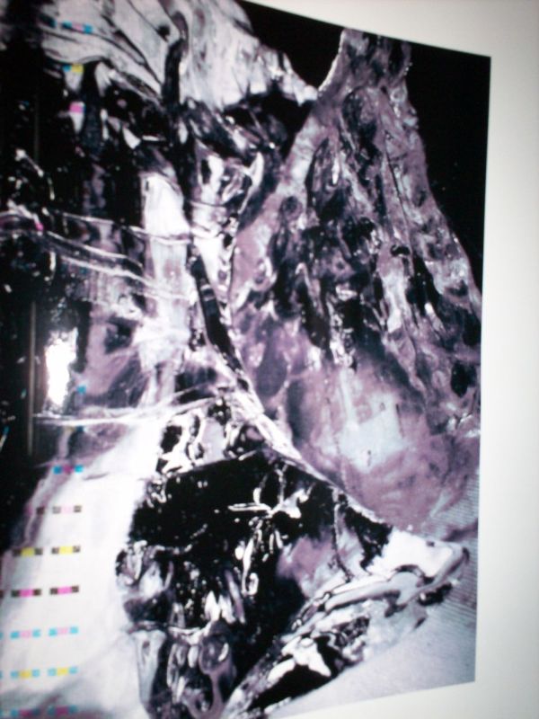

All of the sudden the greys went wild.
I have attached 2 pictures, the origianl and the printed one.
Printer is a prismjet extra ( falcon outdoor 46). Anyone have any ideas?
I adjusted the mag. and light mag. down and still to much.. sigh
thanks for the help.

luggnut
i have a falcon and a true neutral gray is very hard for me to hit. it's a profile issue i think. the grays are made with mixtures of CMYK not just blk so if anything is off you get a color cast. i've had better luck with some canned profiles than others. if you don't create your own profiles you could experiment with different canned ones. on oracal 3651 and 3165ra i use a arlon profile that gets me results i'm pretty happy with.
