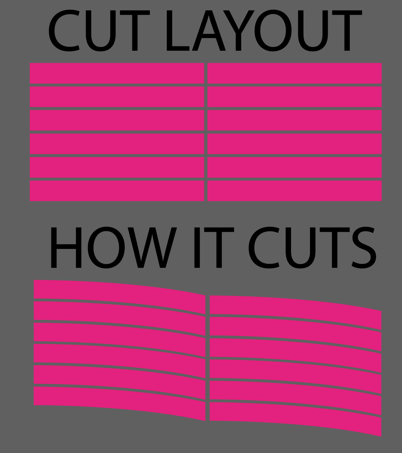

See below cut layout. Issue I am having is the side to side seems to cut fine. Its the feed that cuts curved. (my image below is exaggerated). Over this cut layout of 1m it would curve about 2mm
It seems quite consistent.

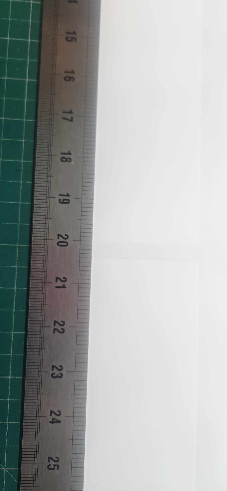

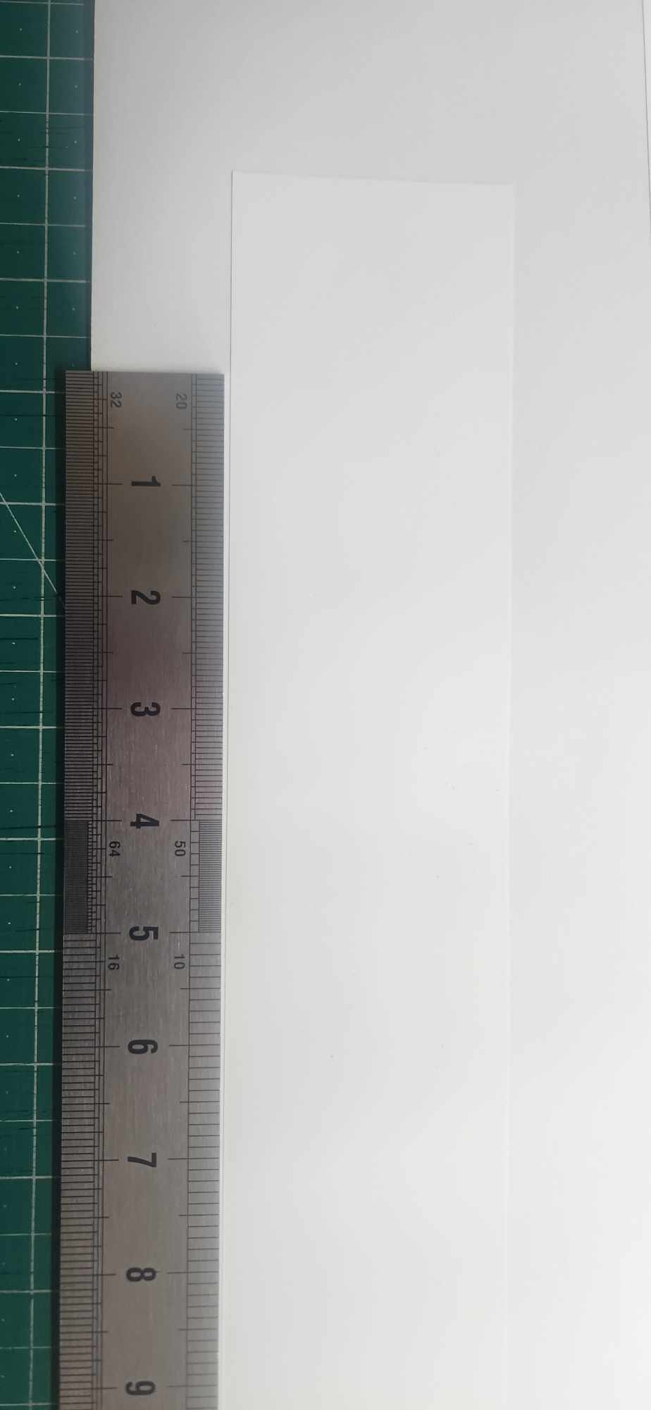

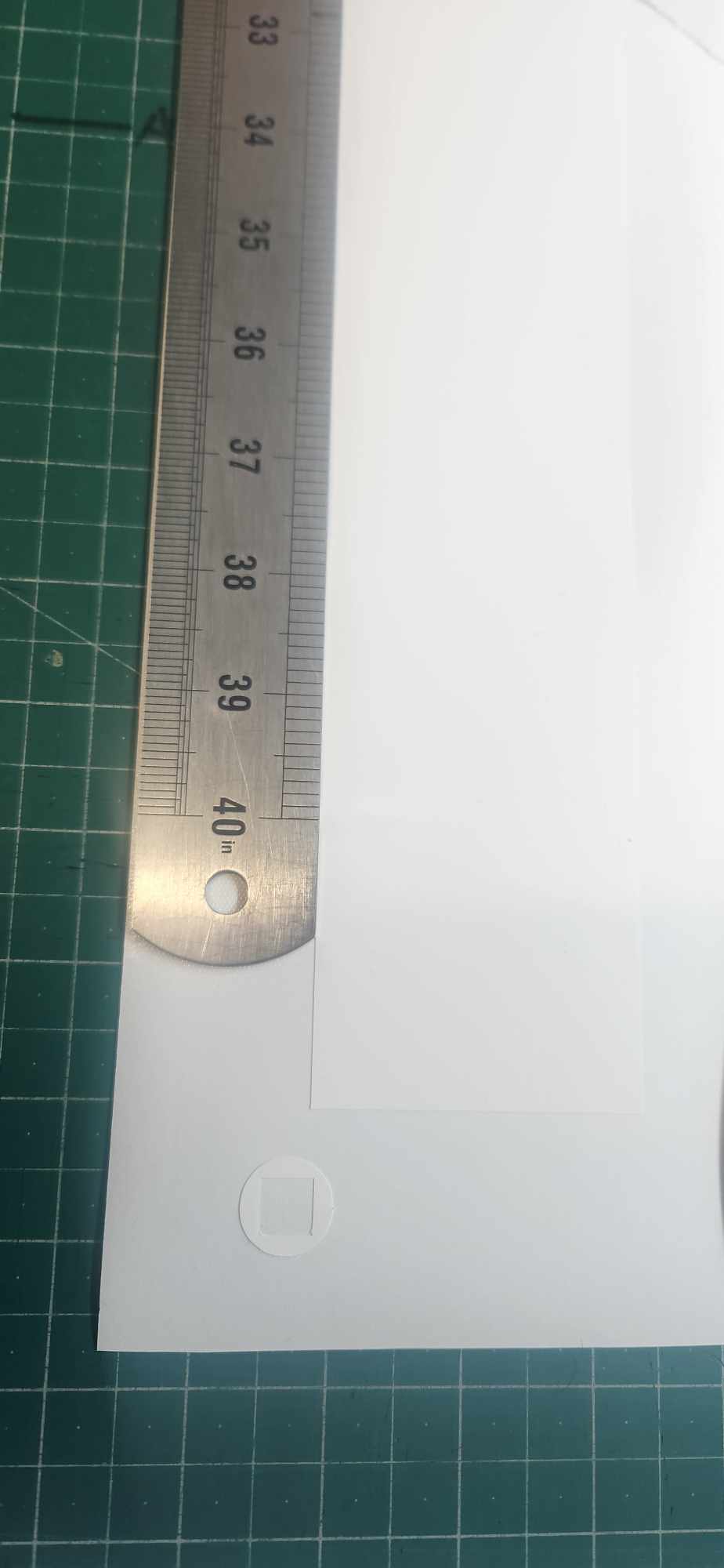

Some more images showing the non straight cut. Starts off straight then ends up on the piss
