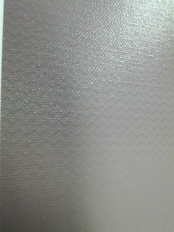

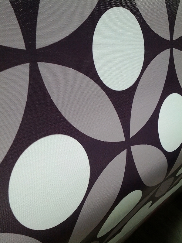

Here are pictures of the weaving we are having
Any suggestions?

Anyway, can you post a picture of the problem, it's hard to diagnose without seeing it. I suspect it's a media feed issue or profile issue though. Does it occur with different profiles as well or is it specific to just one profile?
I have posted the pictures above. It is weird because it is not profile specific. It happens randomly, and more frequently these days.

From what it looks like in the picture the wave pattern is only in a small portion of the print and before and after that spot are printing correctly, is this right? If this is true does this wave pattern repeat on a consistent basis? If the answer to both questions is yes then it is most likely dirt and ink on the PF Encoder Disk. The disk is located under the left hand side end cover. It is about the size of a CD and has a thin black band running around the outside of it. The printer reads this band to tell it how far the media has moved. When dirt gets on this disk the printer miss reads it where ever there is dirt or ink and the printer doesn't move the media the correct amount. You can clean the disks using a lint free cloth and isopropyl alcohol. Pinch the disk with the cloth and gently clean the entire circumference of the disk. Be careful not to bend the disk or crease it in anyway, if you do you will have to replace it.

An inconsistent, intermittent dark banding like that is almost always due to media feed and tensioning issues. If you're running large rolls, the feed motor has to strain to pull media through when it runs out of slack. Then it goes back to smooth sailing, until it has to turn the roll again. Rinse and repeat.
The only solution to large rolls on that sort of printer, without a powered and tensioned feed unit assembly, is to manually unroll media so that the PF motor has a consistent amount of tension on the feed.
