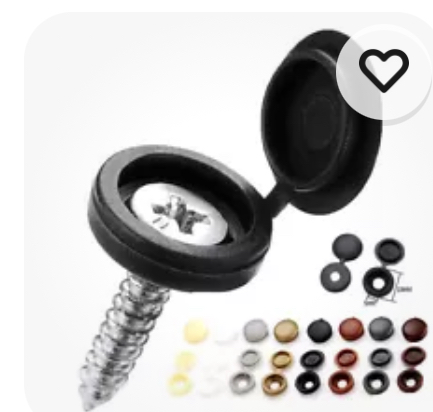

I’ve done French cleats with screw cap covers. Drill hole bigger than screw for expansion. I order online, however big box hardware stores have them. They mainly used in furniture…. Makes for a nice finish look.
