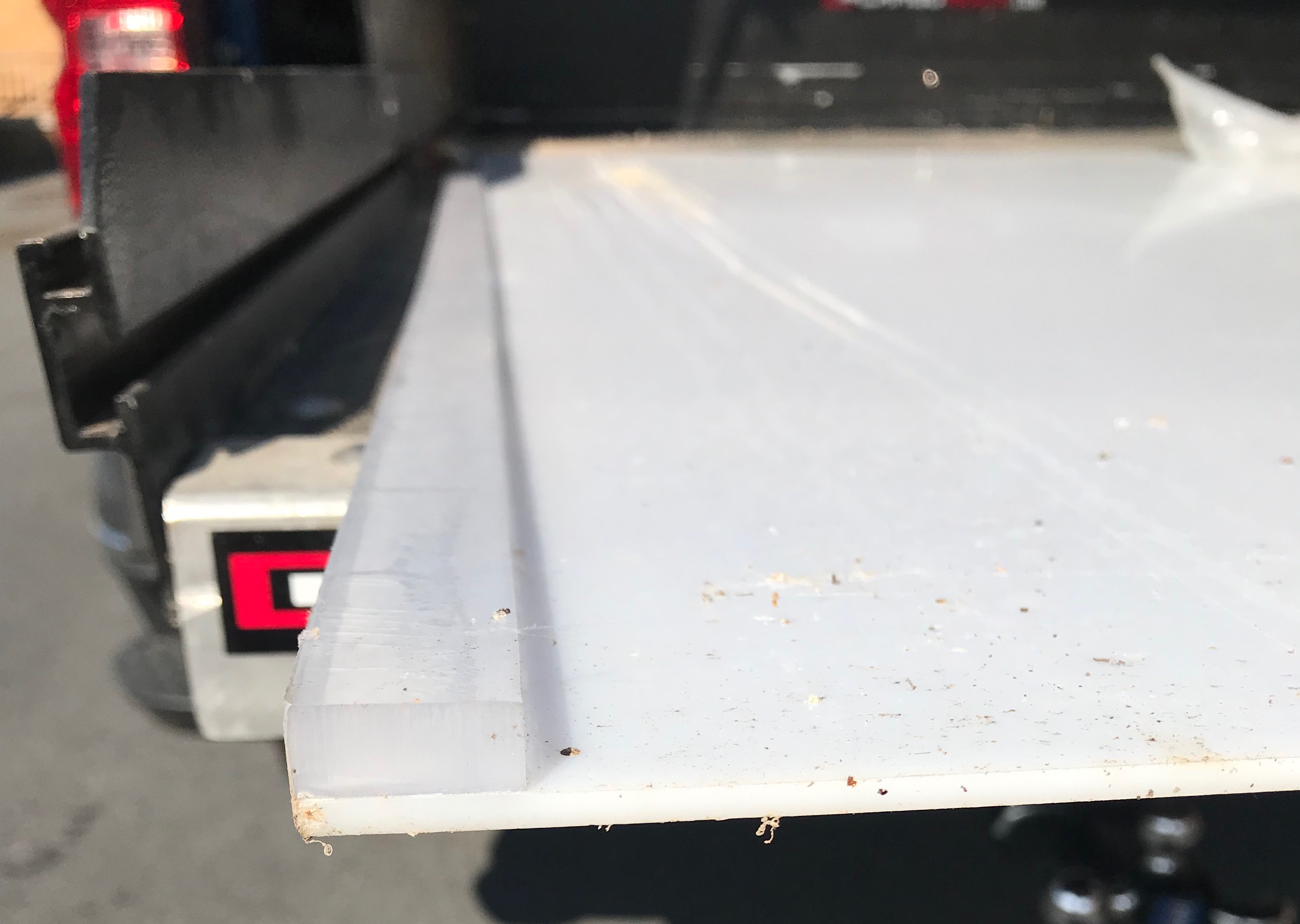

Thanks guys. This is what I am dealing with. Don't know why the hanger is so thick. This photo is from the last panel that was replaced. It's a pita to get to the sign to look at the box, but it probably our best bet. Means an extra trip with the bucket truck, and dealing with school officials - it s going in a goalpost sign on the football field.

I'm guessing they used extruded acrylic or polycarbonate bars to do that. 0.625"x1" or something like that. You can buy them at Amazon in 6' pieces.
signbrad
I almost always used hanger bar that I bought from a supplier. It was smooth and in the neighborhood of half-inch, as I recall. Not having a cut edge—I assume it was extruded—it allowed faces to slide easily.
Most of the lighted signs built in the shops when I was coming up were scratch built by sheet metal guys—aluminum or Paint Lok skins on angle iron frames. No knock-down kits. The retainers were fabbed so that the top one supported the bar solidly from it's reversed lip. I have also made my own hanger bar before, as others mentioned, but I always doubled the plastic to yield at least a 3/8-inch thickness. A store-bought bar consistently performed better, however.
On some large faces I have even seen hanger bars at both top and bottom. And one high-end shop I worked at put the bars on the backside of the plastic, rather than the face, and then fabbed the cabinet with a notch at the top front for the bar to ride on. Very sturdy design.
