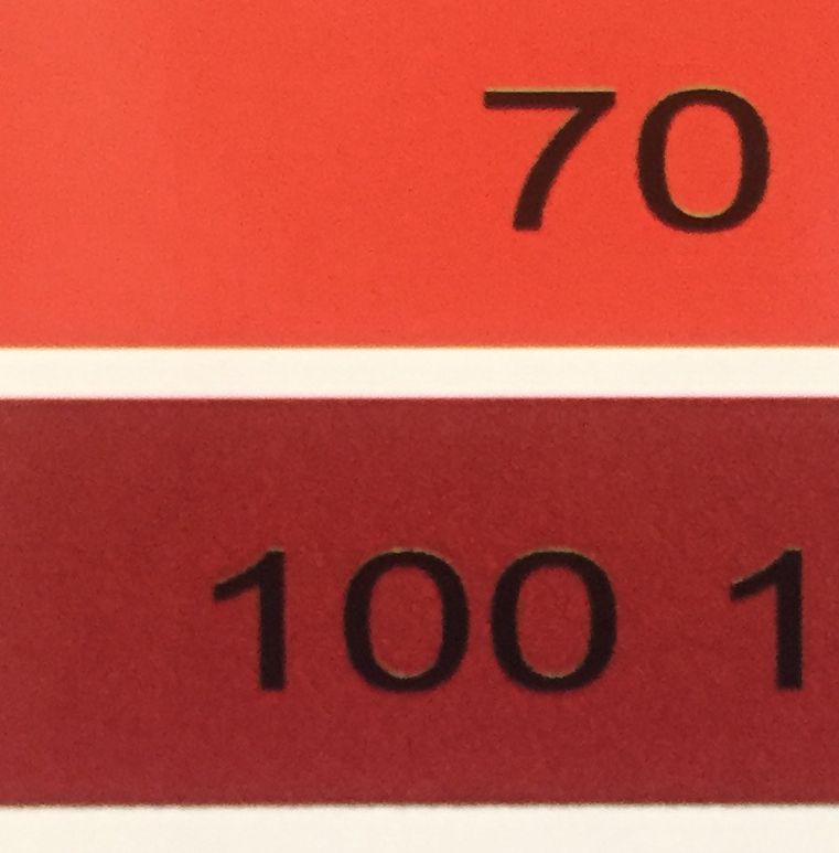

I know I've done this before but can not remember what to call it. But lets say when you have black text in a color I have a slight white gap on the upper and right of the font. I don't think this is pf adjust. Do I need to align head better? seem to happen more cyan and black. Print amazing other then this (1204 with all new printhead, dampers and new MS)
letterman7
Looks like it might be a RIP error, but definitely check your PF first. Every now and again I get that, and it's always a feed issue.
rrd
Nevermind, I found it. The little lever on the side of the head carrier was the ticket. Two clicks of the lever now prints perfect
