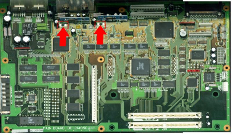

Where is the head fuses on my falcon jr, I cant find anything in the manual about them....and dont see where they may be anywhere...

I dont know anything about Mutoh, BUT on the Main PCB you have to look after a small white/gray fuse, usually there is white writing beside it (F1,F2 or F3) i Dont know what fuse that is for the heads but measure them all to be on the safe side
Measure it to see if its broken or not !

Yep, two little squares less than 3/16". Labelled F1 and F2. On the motherboard, toward left side and back. I believe F2 (the one on the left) is the black head.
But yes, check with a meter to see if they are blown. But first, turn off power, unplug cord, turn power switch on for 5 min, turn off power switch, then test. If not, the charge in the power supply may blow the fuse, even if it's unplugged and turned off.
Ask me how I know. :)

No, it's on the main board that's located down below. It's located in a black box. You undo 3 screws from the front, then the box will drop down hinge-like. Then inside there is a cover you need an allen head wrench to unscrew 3 more screws. Remove the cover and you'll see the motherboard.

My Lord, have patience man, this has been posted many times before... See the attached picture...
