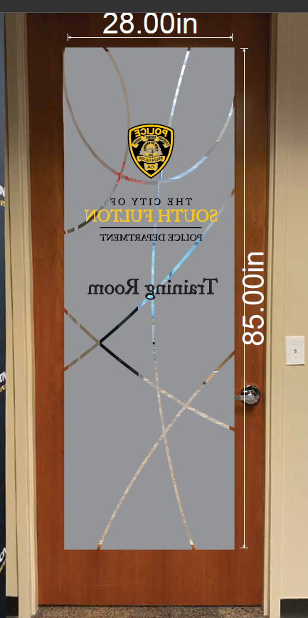

As an alternative to printing on frost, we've cut out logos or just lines and curves or shapes. It looks really beautiful and classy. It also means you don't have to worry about ink/vinyl matching problems.
