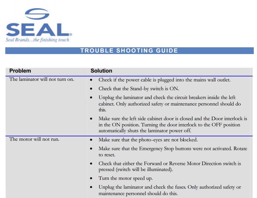

My money says somebody bumped the E stop,
LOL, that happened with our Kala one day. I was getting really frustrated, and worried that the laminator suddenly up and died inside. It turned out to be the E stop. someone hit it by accident, and it took me about half an hour to consider that and check it.
MNT_Printhead
No longer working among the Corporate Lizards!
I use the e stop on my Kala often and then forget when I start it up again. Usually when I have problems with this slitters or can't hit the stop button from the back of it. I need to buy the remote for it.
JBurton
Signtologist
I have about 3 different e-stops that folks forget about, ask for me to look at a machine, so I can once again show them the big red button that nobody touched...
  • Hilarious!
Reactions: 1 users
Joe House
Sign Equipment Technician
I got called for a laminator service recently on a model that I wasn't familiar with. It was dead, so I started at the outlet and traced the power. The 3rd item in line after the power entry module and fuse was (you guessed it) a safety switch. I turned it and the laminator came to life. I felt a little silly. The customer was ready to roll it out to the curb. He was happy that I "fixed" it for him.
  • Hilarious!
Reactions: 2 users
JBurton
Signtologist
  • Hilarious!
netsol
does your model have 6 keys like mine does?
i believe turning any of the keys also triggers an emergency stop
