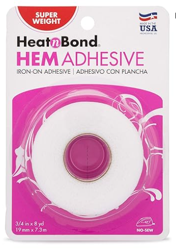

Can anyone recommend an iron-on hem tape that is suitable for canvas? Specifically, I'm using the Magic 15mil polyblend (https://www.grimco.com/Catalog/Products/MagicGFCVM).
Our F&B department continues to last-minute me for menus and I don't have time to send them for sewing. Would this stuff work?
A simple google and you'll see it's for interior things like curtains and other thin fabrics.

we’ve used regular double sided banner tape before and it was ok but definitely not as great as on vinyl scrim.
You might want to test it out and see if the heat will damage the print at all.

Thanks for the suggestions. I'm currently testing regular scrim banner tape and some of the iron-on hem tape I posted above. These will only be about 2'x3' and will be hanging under covered patios, so hopefully they will last a couple months until it's time to update the menus again. I'll update with my results. Thanks all!

Okay, well, the iron-on hem tape works about as well as regular banner tape - IF you manage to get the heat/duration perfect. Some test pieces held really well in spots but left some spots completely unfused. So, I'm scrapping the idea of iron-on hem tape. Not worth the extra effort of trying to perfectly iron it. It could also be this particular material - it's pretty smooth. Could be why the regular banner tape works well enough.

have you tried a fabric store? There are some hem tapes for material that might fuse better without an iron.
