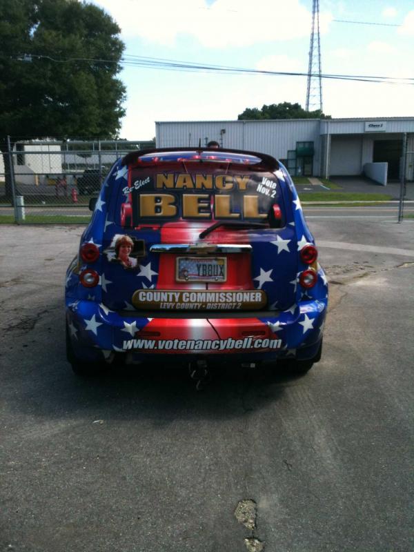

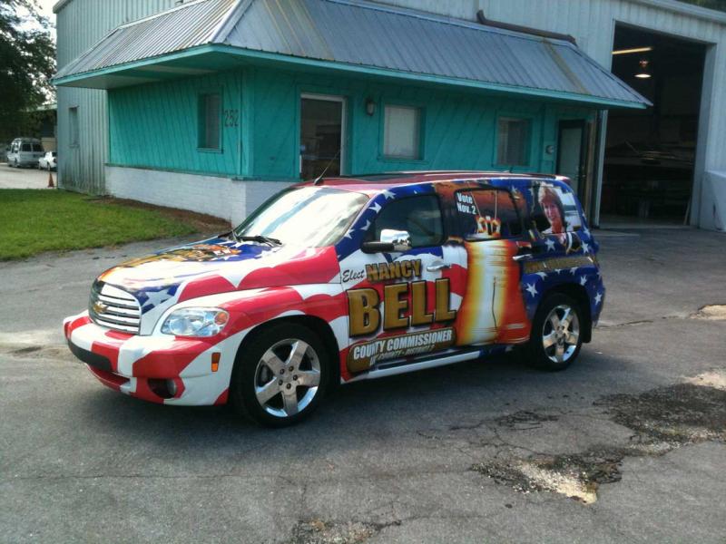

pics

Don't forget your primer94. We wrapped an HHR last Dec. and had it come back this week for a couple little spots that popped out that we had forgotten to use it on. (2nd layer of vinyl that went from the doors onto the fenders)
We used 180c v3 w/ 8518 lam, though it some places I had wished for the 380c.
