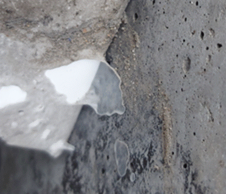

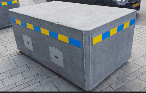

I just removed printed and laminated vinyl from concrete crash blocks.
The adhesion was the same on both concrete and reflective areas
and was pretty easy to remove. It feels more "rubber-y" than most vinyl.
Customer says its been on there for three years and was installed on site in 3-10 degrees celsius (37-50 fahrenheit)
And now they want me to redo it in the same material, but they dont know who did the original work.

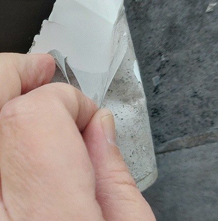

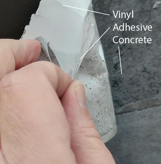

The thing that might help someone recognize it is the adhesive.
It's thicker than anything i think i have seen. And it partially lets go from both the vinyl
and the concrete like that tacky stuff for posters.
