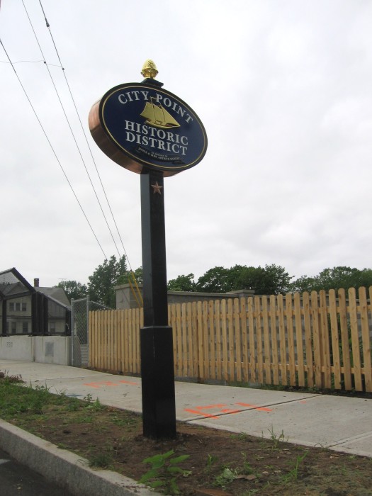

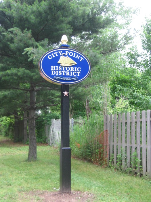

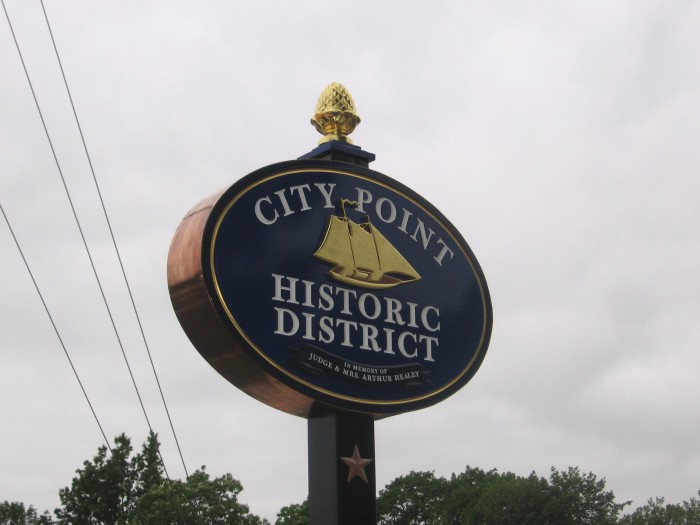

We did two of these carved HDU with acrylic poly background and letters, PVC gold leaf ship symbol, pvc painted dedication ribbon, gold leaf routed border, copper wrap, 6"x6", PT post with 5/4", PT skirt boards, gilded carved pineapple finial (purchased), stamped metal star with copper paint. I really appreciated the woman who donated the signs taking my suggestion to do the carved letters in white instead of gold leaf, and just use the leaf for accents​
