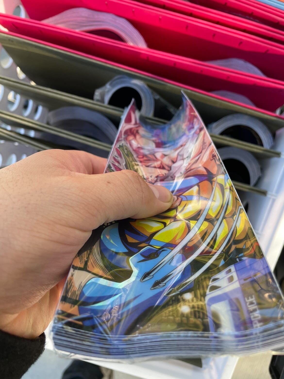

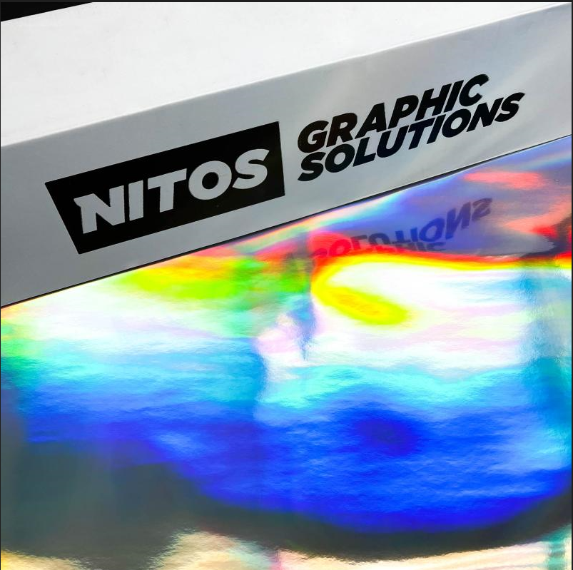

Does anyone know how to fix this? We're printing with an Epson S80600, and Laminating with 210G, on a GFP 563TH.
The edges arent curling so the vinyl isnt failing. It's more like the entire sticker/slap itself is curling upwards.
This is only happening to our holographic vinyl, this doesnt happen to our 3m reflective vinyl, or Oracal 3651 vinyl.
When laminating a roll, we crank up the vinyl tension as hard as it can, almost to a point where it slows down the motor a bit.
(Our reasoning for doing this is because if the laminate is too tight, it curls upwards. So if we tighten the f*ck out of the bottom vinyl, it will curl downwards, which would be better than upwards.*)
And for the laminate, we give it little to no tension.
Just enough to keep the laminate from sliding left to right causing wrinkles.
For the rollers we bring it all the way down then add 3 inches extra in rotation.
