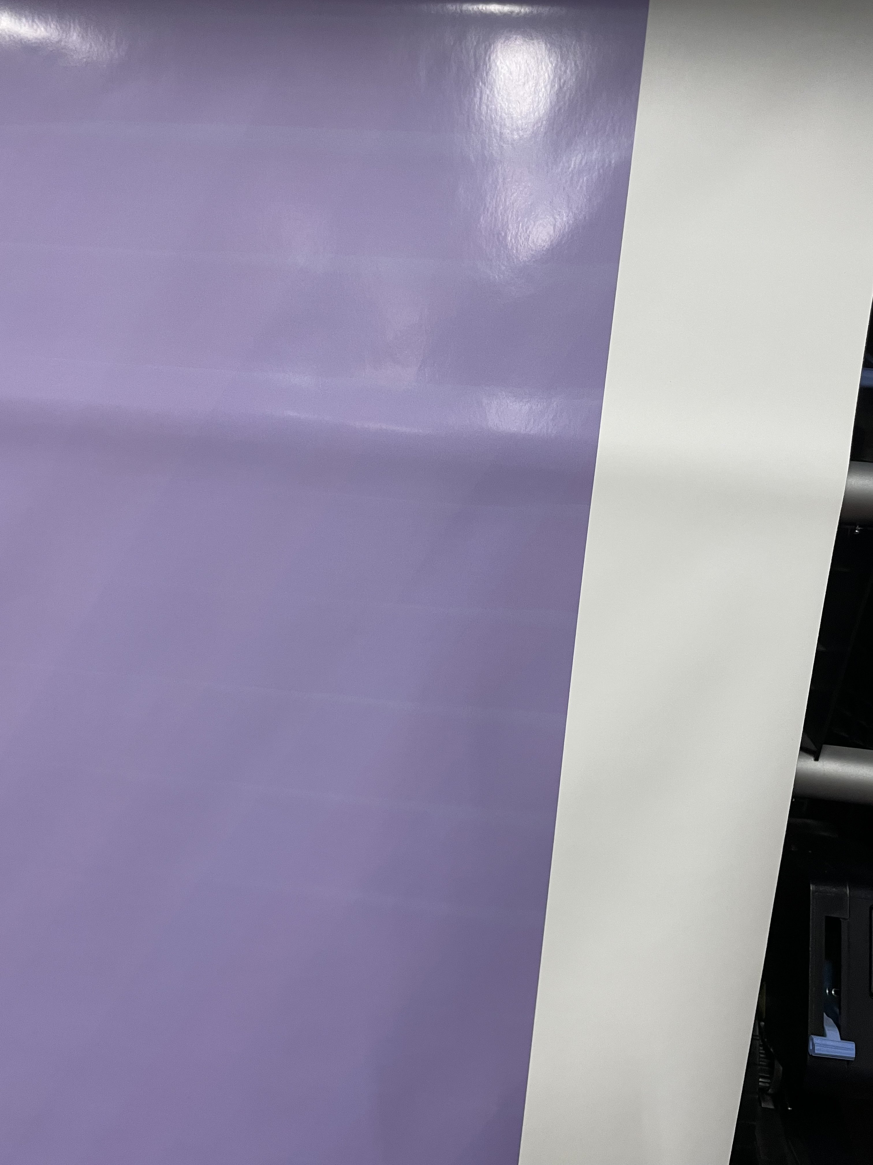

I have been having this horizontal streaking going on on the right side on the prints. I replaced the older printheads, and have done the 'Optimize Print Quality' as well, but they still show up. Has anyone else experienced this or have any solutions?

Replace the light inks printhead (#2) if you have not done so already. On Gen3 printers (300/ 500 Series) this issue (streaks from the right side that diminish as they progress to the left) is related to one or more printheads that is failing.
