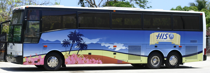

I did a 28 foot bus with 8 vertical panels per side.
I'll call your 28ft 8 panel vertical and raise you a 45ft 2 horizontal panel Vanhool.....
wayne k
guam usa
