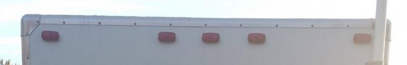

how can i get these lights off of trailers?
0igo
is there a guide online anywhere on how i can get these off of these little trailers anywhere?

Does the red lense pop off and then have screws under it? Wouldn't imagine its fastened from inside the trailer.
This should be the way it is. It helps to get one side out, then slide the other. If they're old though, they may be brittle and break.

The lenses just pop off and then usually 2 screws hold them on. They are dirt cheap to replace if you do break the cover.
