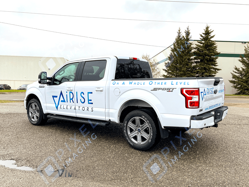

How long does it take for you to letter a truck from start to finish with spot placed graphics, including clean/prep time? No wrapping. Something like the pic attached. Just a fairly simple set of decals, nothing crazy.

I'm counting 3 pieces on the back, 2 on the sides. So that's 7 decals to measure and get straight.

If the truck looks like this, it's easy to measure. Some trucks are more of an "eyeball" situation because they don't have clear lines to measure from like this one. I take that into consideration. A couple times my eyeballs deceived me and I had to reprint and apply - it happens LOL
