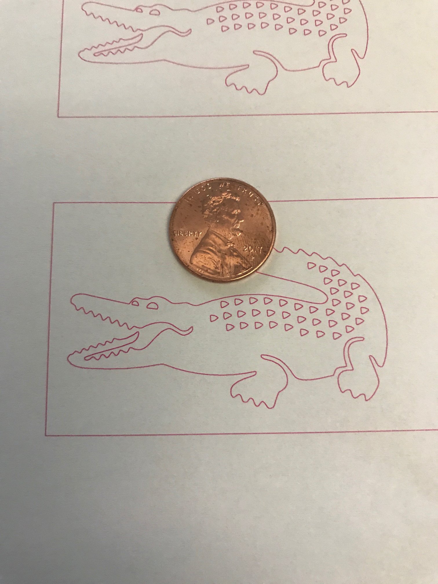

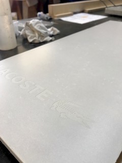

We have a Summa D160 which I believe has the same cutting abilities as the 140 - we did an entire rollout of holographic vinyls that were cut with super intricate lace patterns and it did fine (although let's not even talk about the labor involved in weeding) - the one in this photo was roughly 6 ft x 12 ft, so literally thousands of picks. I also just produced some logos to use as stencils to deboss concrete - the tiny scales on those crocodiles were a real pain but it is possible!
