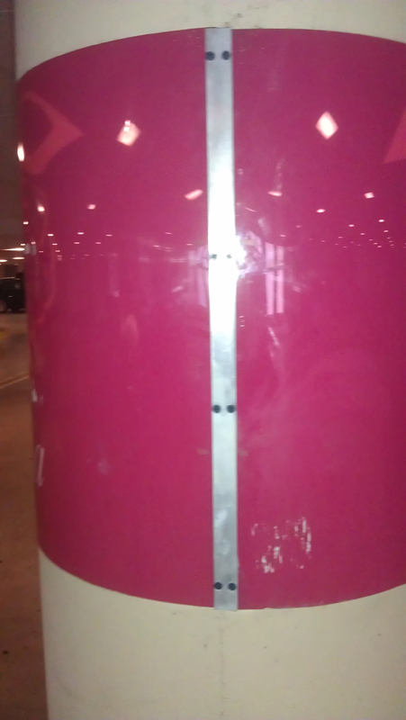

I have a high end client who doesn't mind spending extra if it gives them a look they are after, and I like clients like that... so here's my dilemma.
They are redoing their parking deck and had some of these signs made during a previous remodeling job. Now they are restriping their lots, and want to put directional signage up, and like the look of these. They look like clear lexan, wrapped around the posts, and screwed on, on one side
- but the print is on the inside of the acrylic.
The way I can figure out to do this is double strike print the sign reversed on clear vinyl, then mount it to the lexan, and "laminate" that print with white vinyl. So the print will be opaque and on the inside of the lexan. My question is, will the print bunch up when I try to bend the lexan around the pillar, or is there an easier way to do this with just one vinyl, with the adhesive on the printed side (inside of the lexan).
Am I way off base on this idea, or have you done this before and how did it work?
Thanks in advance!
-Pete :U Rock:

I would be supplying the lexan - the signs that are there look like lexan panels bent to curve around the cement pillars, and screwed in place with another piece covering the seam. The sign that's there looks like the print was either printed directly to the lexan using a flatbed printer that can print white, or doubled with a clear and a white behind it. Are there any other types of materials that you can print, and then apply some sort of adhesive on top of the print, that would be a clear adhesive?

The Pillars are about 8' tell, the signs look to be about 24" or 30" - the metal seam you see on the pink one isnt visible unless you take what they had over the seam off, which looked to be a wrapped piece of aluminum taped the the seam. You can see the covered seam on the green signs' photo.
I don't know about wrapping the pillars, they aren't very smooth. These really look nice installed, and they really like them. This client is not keen on putting square signs on the pillars, they want something the flows around them, and i'm not keen on losing out on a good job by suggesting some cheaper hanging signs from the ceiling. If I can pull this off and offer a nice product that they are really happy with, I don't see that as a bad thing. I think the key to this looking nice is mounting the graphic to the inside of the lexan, and attaching the lexan to the pillar. It will be smooth, durable, and match the signs they already have.
