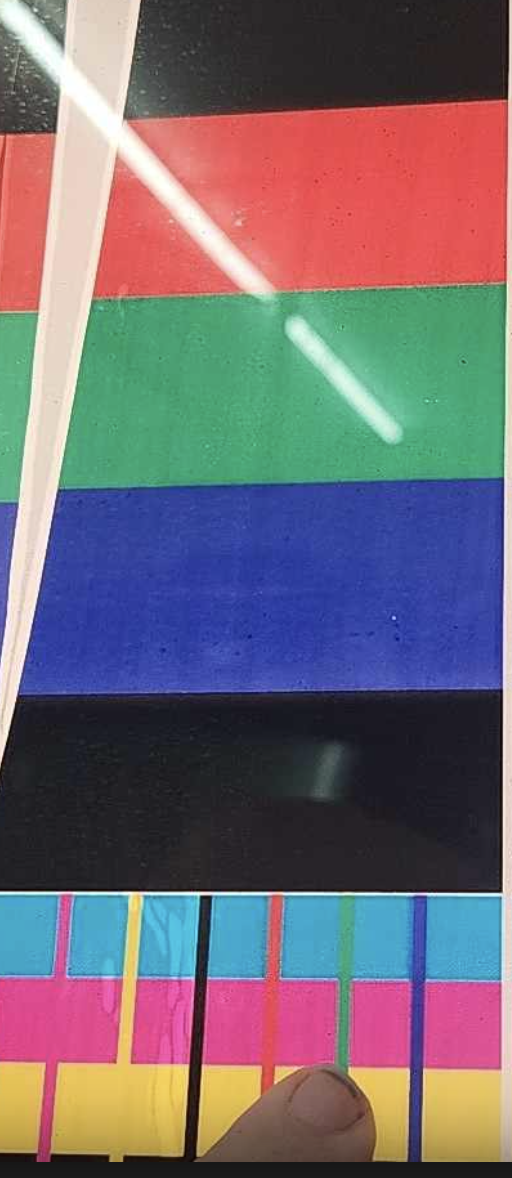

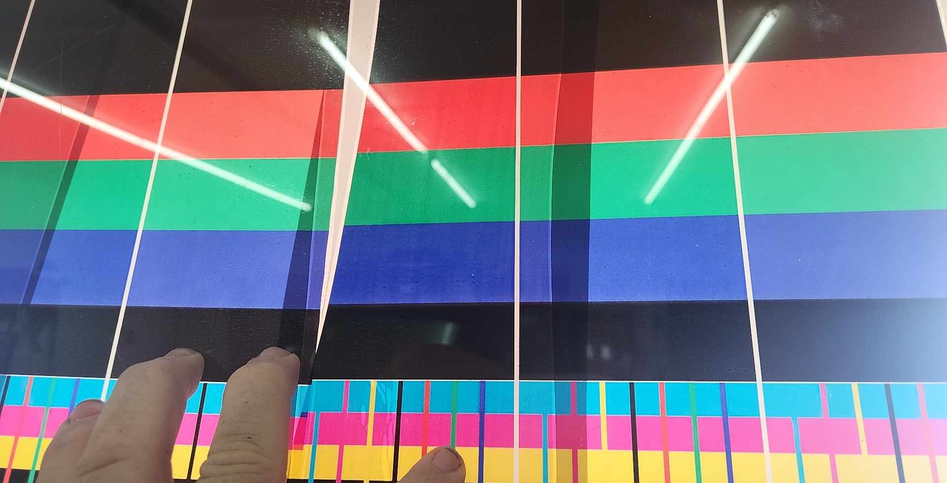

kcorcoran
Printing on HP 310 with Flexi Basic
- Printing reverse image on clear laminate.
- Mounting to glass/plexi.
- Backing with thin white vinyl.
I started with the generic adhesive backlit profile and ran calibration.
Ended up with 2 profiles
- 20 pass at 130% (probably could have gone to 150% but was sure I saw a little bleed)
- 16 pass at 130%
They both look very nice with reflective light but even on 20 pass 1305 the black is a little more washed out than I'd like it to be.
Wondering if I can get my blacks darker, maybe with some setting in flexi, to get it to lay down a little more black ink?
Thanks in advance.
