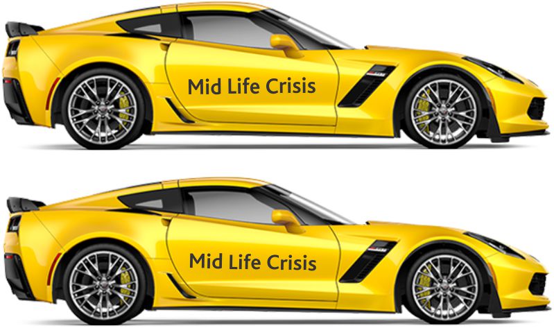

So which line would you use? Bottom is going off the rocker, top is the indented line in the door. I usually like to follow the rocker and the overall rake of the car.

So which line would you use? Bottom is going off the rocker, top is the indented line in the door. I usually like to follow the rocker and the overall rake of the car. View attachment 154404
I would go with the top for name, city, phone type stuff. If it's some kind of fancy race thing like Mid Life Crisis in cursive with a slant and some checkered flags behind it then the rocker.

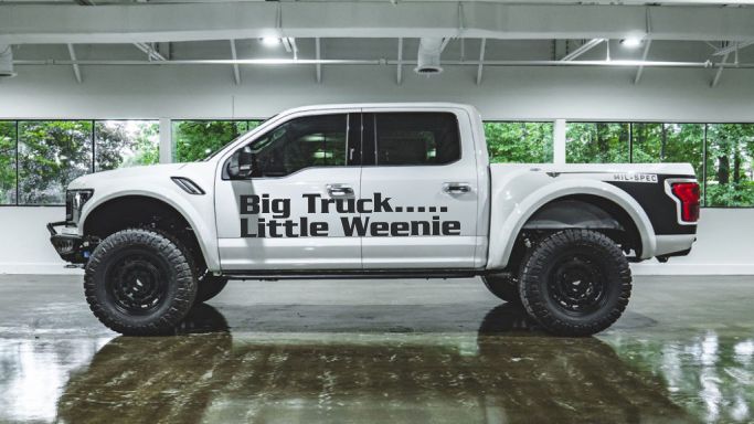

Trucks are usually pretty easy, I'd still go off the bottom of the rocker or door or door line, since the lines are usually pretty level. I think that's what visual meant by level, relative to the vehicle, not the ground.

I've learned to just eyeball it.
Theres no reference points on a vehicle. Listen and learn.
If the customer thinks something is crooked..... well, I'm quick to argue with him... these are just stickers, here. We're not tuning a piano . Does this look like a piano.
