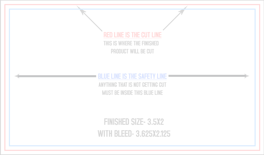

correct, there is the BLEED, CUT & SAFE lines. Each line is 1/8" apart.
myront
Dammit, make it faster!!
When referencing your image it seems your bleed size is based on 1/16" not 1/8"

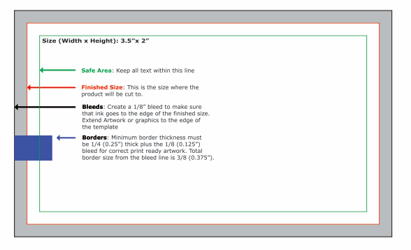

This is their specs
Dan360
Safety margin will differ based on their capabilities, 1/8" is standard. At 1/16" they're confident in their production equipment or they run on a press.

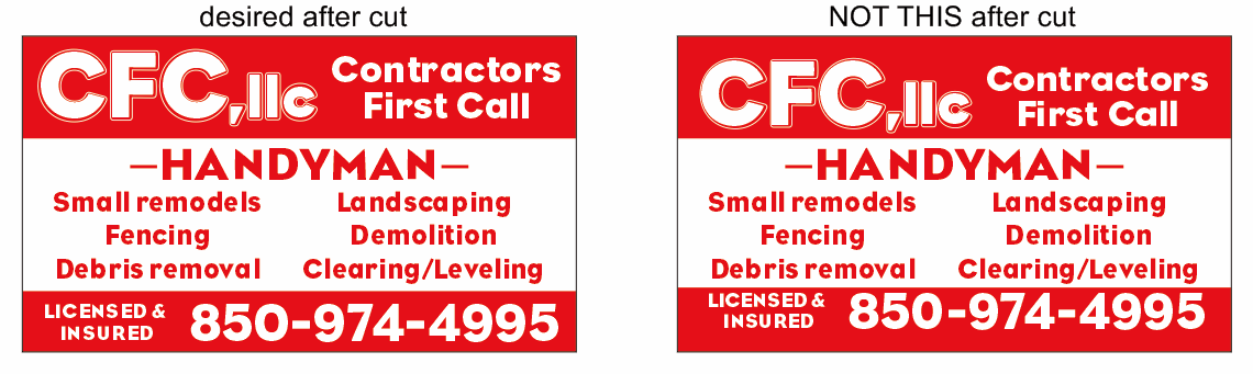

The design could easily accommodate a 1/8" safe line with some layout adjustment (I would not recommend the "NOT THIS" example).
