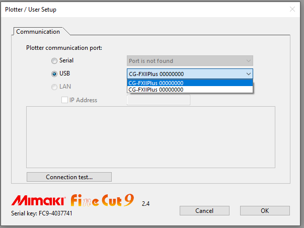

Hi there, my company just bought 2 CG-160FXII Plus, how can i use 2 plutters with just 1 machine, i know that is samthing with the ports, buy i have a lot problems findind the way.(And I have already tried to follow the instructions in the manual, but nothing has happened.)
Windows 10 Pro
CG-160FXII Plus x 2
illustrator 2022
Fine CUt 9
Fine Cut 9 / Comunication /usb/ CG-FXIIPLUS 00000000
bouth have the same number...
Each USB port should have the serial number of the machine next to it. Since it doesn't, I would say you need to update the driver. If that's up to date, something is up because I've never seen the serial number be 0000000. The serial number is how the computer knows which machine to send to.

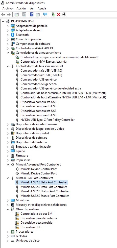

go to device manager,& right click on each usb port & root hub
also, go to the manufacturer site & find the exact chipset driver for your laptop

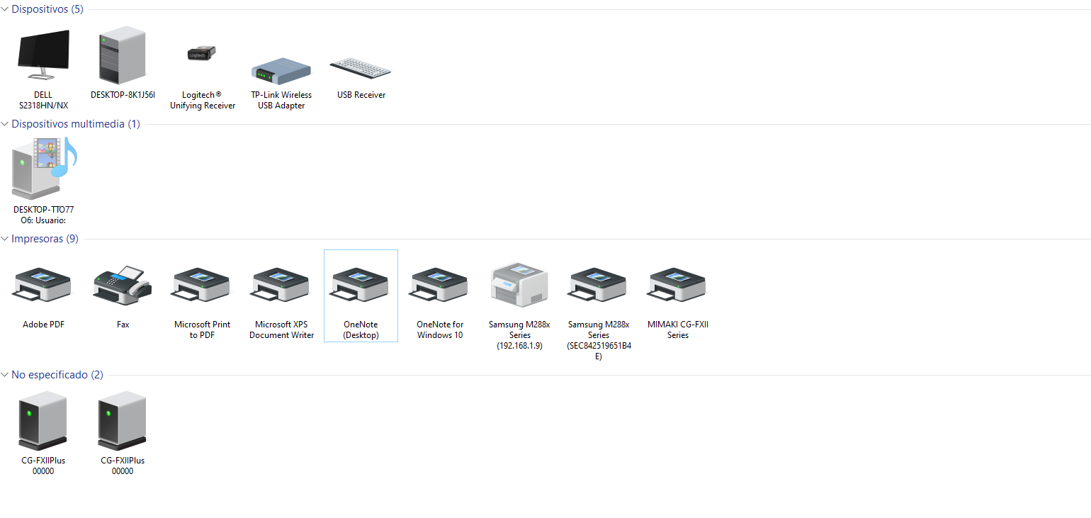

as long as one is printing, we can assume the printers are both responding to polling requests & should respond with a serial # the same way a network interface responds with a 26 digit mac address
try updating each of the usb ports in device manager by right clicking and choosing the option to update driver & choose the windows
update option
take the time and go to manufacturer website and download chipset driver for the pc
do you have access to another pc (a laptop perhaps?)
this would answer the question if the printer is sending serial # info back through the usb's

As long as they show up as 2 different devices - just see which one comes in when you plug it in and assign a name to it - either way - just plot to the one that comes up
