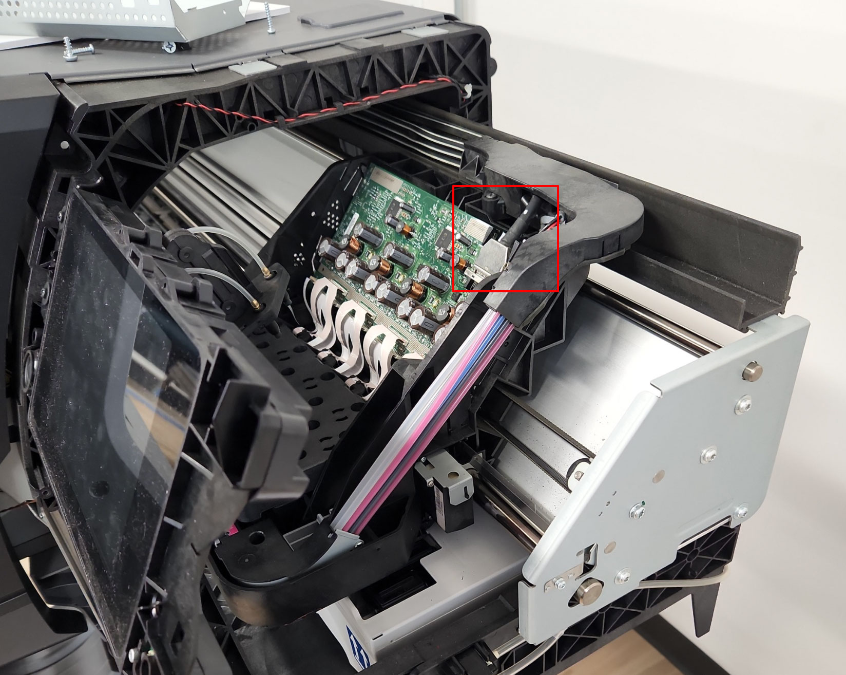

So this error is pretty much only pointing to the Trailing cable. What I would do is check both ends, take out the connector and put it back. Also to check the cable because this cable is known to break at some point, the rubber outside breaks and the wires twist and cut.
Remove the display side end piece so you can see the top of the carriage. Take the trailing cable connector out and plug it back in. Remove the small plastic cover behind where the LAN cable goes to. There is the other end of the trailing cable, reseat that.
After that open the window and reach up to the top panel, under that you will have the trailing pack with ink tubes and cables. Lift that down (it's on a U shaped channel), open it a little bit and inspect the trailing cable for any damage.
If you can see the wires inside, it's going to be broken now or very soon. It needs to be replaced.
If you need it I have the spare part number just for the trailing cable. It's like $150 and easy to replace.
DO NOT pay for the large cable package that is like $1500!

And to add a bit more, you sure can have an issue with the carriage PCA or the PCA that sends the data as well or really anything But the cable has been the issue for 9/10 times.
This trailing cable fits for you :
2ET72-67020 Trailing Cable

I had the same problem, it was pretty hard finding the image of the trailing cable online. I am using the HP 560, but I imagine it's similar to the 360 series. I took off the right side panel and the panel where the lan cord goes into. I disconnected both sides and put them back in. The printer started working after that. For some reason, the back panel where the Lan port is was hitting the cable and caused some type of kink to make the printer not work. This post probably saved me $1700!
twister
This thread totally saved me from having to get help with my Latex 365. In the past the error message would go away from a powering down, unplugging and rebooting after it had sat for a couple days but this time that didn't work. The photo really helped me located the cable and it was a loose connection issue at the board as it now works as before. It's not the tightest connection so if it happens again I may devise a was to secure it more than the factory. Thank you for the information.
