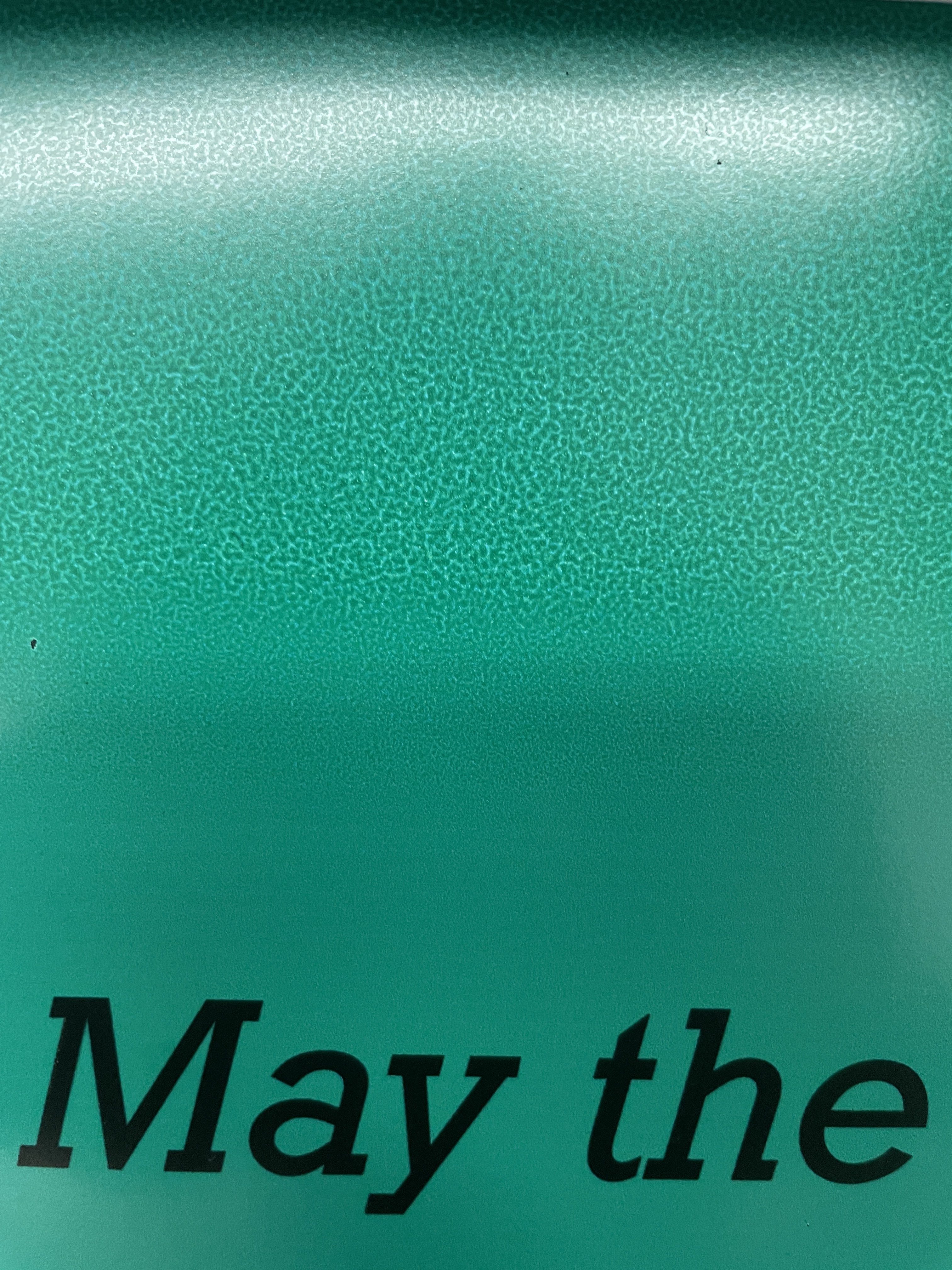

2. I went on and ran a print, it started off just fine, but after a foot or so it began printing very splotchy. Upon closer inspection, it also was banding slightly prior to the splotchy region, and it was running at 20 pass, comparing to the last print of the same file, there is no banding.

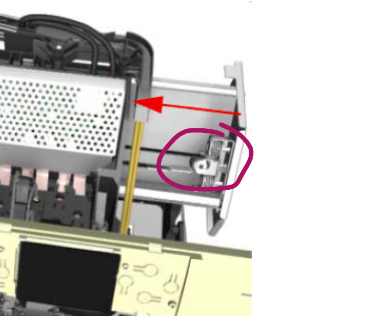

Either the line sensor is not seated correctly or he didn't calibrate it.
By the picture your optimizer printhead is gone.
Just oil it. He should have done it but yeah..

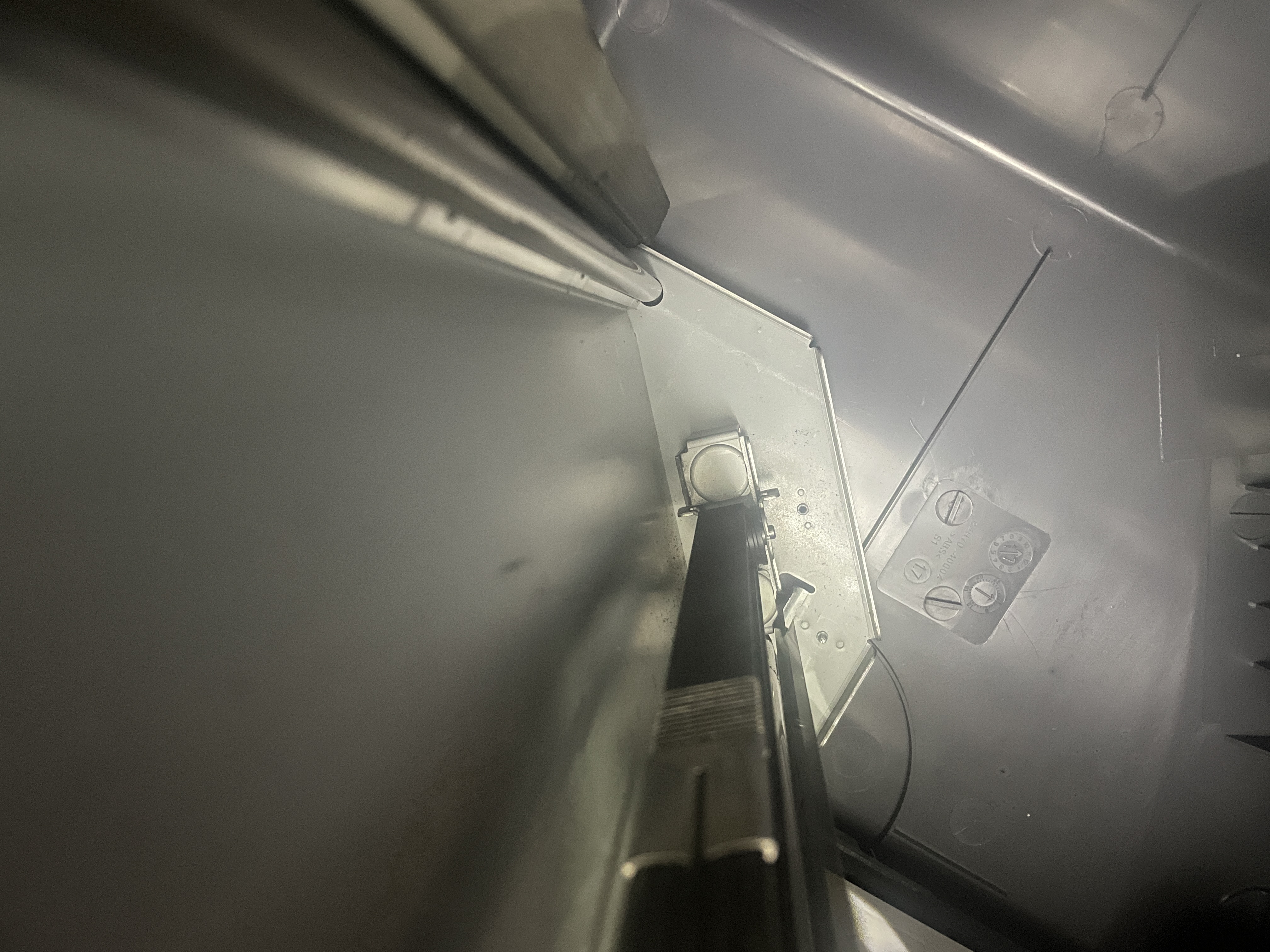

The tech is going to call tomorrow morning to walk me through reseating the line sensor.
