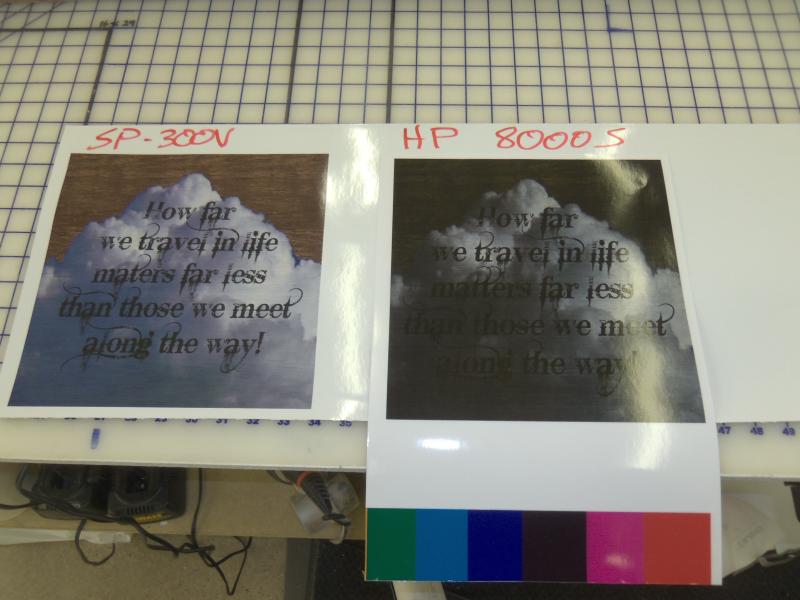

I then printed the sign 10" x 10" on both my 8000s and my roland sp-300v (again I know the 2 printers are going to print a bit differently) but this is WAY off, not sure the picture I took will do justice, but it's not printing the brown or blue hues worth a damn... it looks more grayscale in the side by side...
is there an adjustment I can make? is it a software issue, or is it actually a physical issue with the printer? all 6 ink cartridges are 100% full but read between 5 -30%

You need to profile and make a ICC to match color of files. Online you might be able to find some, but nothing like your own.
You need a Spectrophotometer.

Sometimes we get images like that and they were set in RGB. Just change to CMYK and give it a try. If not test with profiles off and on and see the difference. Are you using the onyx that came with the 8000?

well... i worked late last night and got it figured out... I'm using Flexi Production Manager and there is a small dropdown menu that says, use color correction, use linear correction only , and no color correction... it was set on linear correction. Switched it to use color correction and selected the proper media profile and it printed right now...

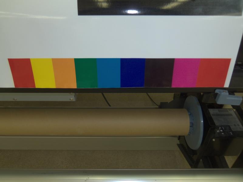

I set the size of the print back to 50"x50" and set it to print, checked the color after it began printing and set my takeup reel, closed up shop and went home, got in this morning to see the color messed up on the print... it printed the proper colors for about 12" and then one (or more) of the colors dropped out completely. the brown wood grain printed bright green... i opened up the machine and i can see air in the ink tubes, I tried to run "Charge Ink Sys" but it wont run since my chips in my ink cartridges are bad and I can't find new ones... all ink cartridges have new ink bags in them as of a few days ago...

These were known for similar issues back in the day - it's not ink starvation to the heads (you can actually starve them by doing too many cleans as you have seen)
It was often caused by the heads drying out on long print runs.
One fix was to turn on the printing gutter (sometimes called confidence strip) in your rip.
This is a set of CMYK lines running down the outside of your print - it forces the heads to spit a little ink from all the heads at the start and end of each pass.
Then the heads don't dry out if they are not needed for a while due to what colours are in the file.

yes, you always have to run the Media Stripe ON.
go into media reg, find media stripe setting, make sure its on. You may also have to turn it on in your RIP.
