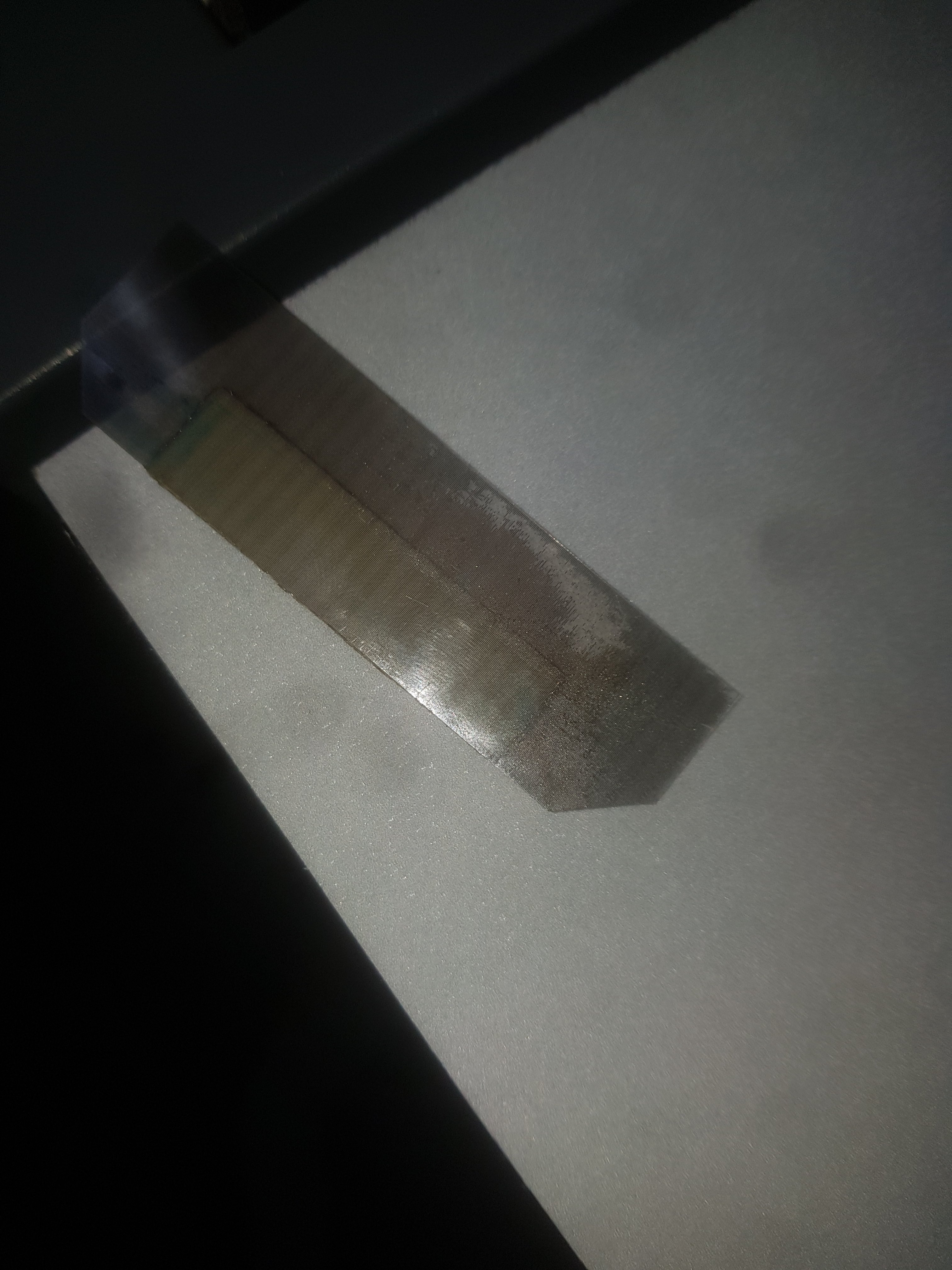

Check the lift encoder.
Had one the other day that seemed to just lose a section all on its own, operators dont go in there so I beilve the story.
They are super easy to replace and recalibrate.
To remove, simply pull it upwards and out.
Youll need to recalibrate once you put it back.
See attached
