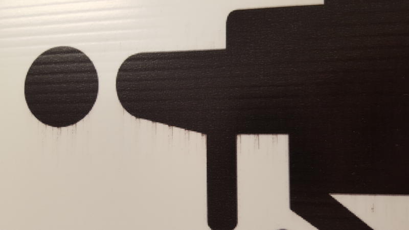

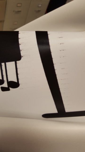

Here is what it is doing, only on the color black:
EDIT: I ran 8 signs successfully with no issue and then it progressively got worse. Originally starting on the left side prints but it has effected all of the prints.
There is definetly something on the bottom of your carriage. That or the black prinhead is completyly out. When you cleaned the printheads were any of the edges of the bottom popped up. This will cause problems like this.

There was a tiny piece of vinyl caught under the carriage. It took some work but I got it out and it ran like a dream. Thank you SO MUCH everyone. Appreciate it more than you know
Also I can't really tell if it is the image or if it is the print There is stepping which is the print but it looks like there is a slight shadow. But you might benefit from a head alignment. This might be because one of your black heads is misaligned a little bit. Especially if you cleaned them and didn't run an alignment.
That print had been laminated and mounted on corrugate which is why it doesn't look so neat
