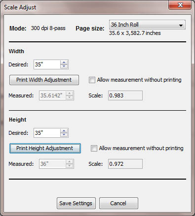

As I understand your post, the deviation is in the media feed direction (versus the carriage scan direction). This can occur due to variations in the thickness of various medias, and how those medias are being moved by the media transport system in the printer.
Many RIPs have tools that can be used to compensate for this. Onyx for example has a function called Scale Adjust which can be used to compensate for size variations in either direction, when printing on a specific media product. It is located in the Media Manager application > Media Library > Choose Media > Choose Print Mode > Edit button > progress through to the Basic Print Mode Settings screen, where the control is located.
