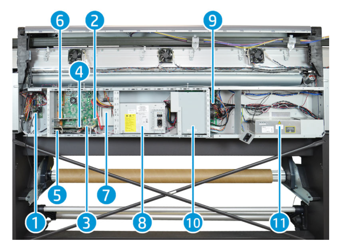

17.0:11 – PrintMech to Interconnect Power cable does not seem to be connected
1. Check that the PrintMech to Interconnect Power cable is not damaged.
2. Check that the PrintMech to Interconnect Power cable is correctly connected to the PrintMech PCA and the Interconnect PCA.
3. Replace the PrintMech to Interconnect Power cable (which is included in the Electronics Module Cable Kit).
1 - Interconnect PCA - Connector J6
9 - Printmech PCA - Connector J18

Disconnect the cable and test it with multimeter to be sure. You can also check that voltage arrives there.
When you start the printer far does it get to? What does it do?
