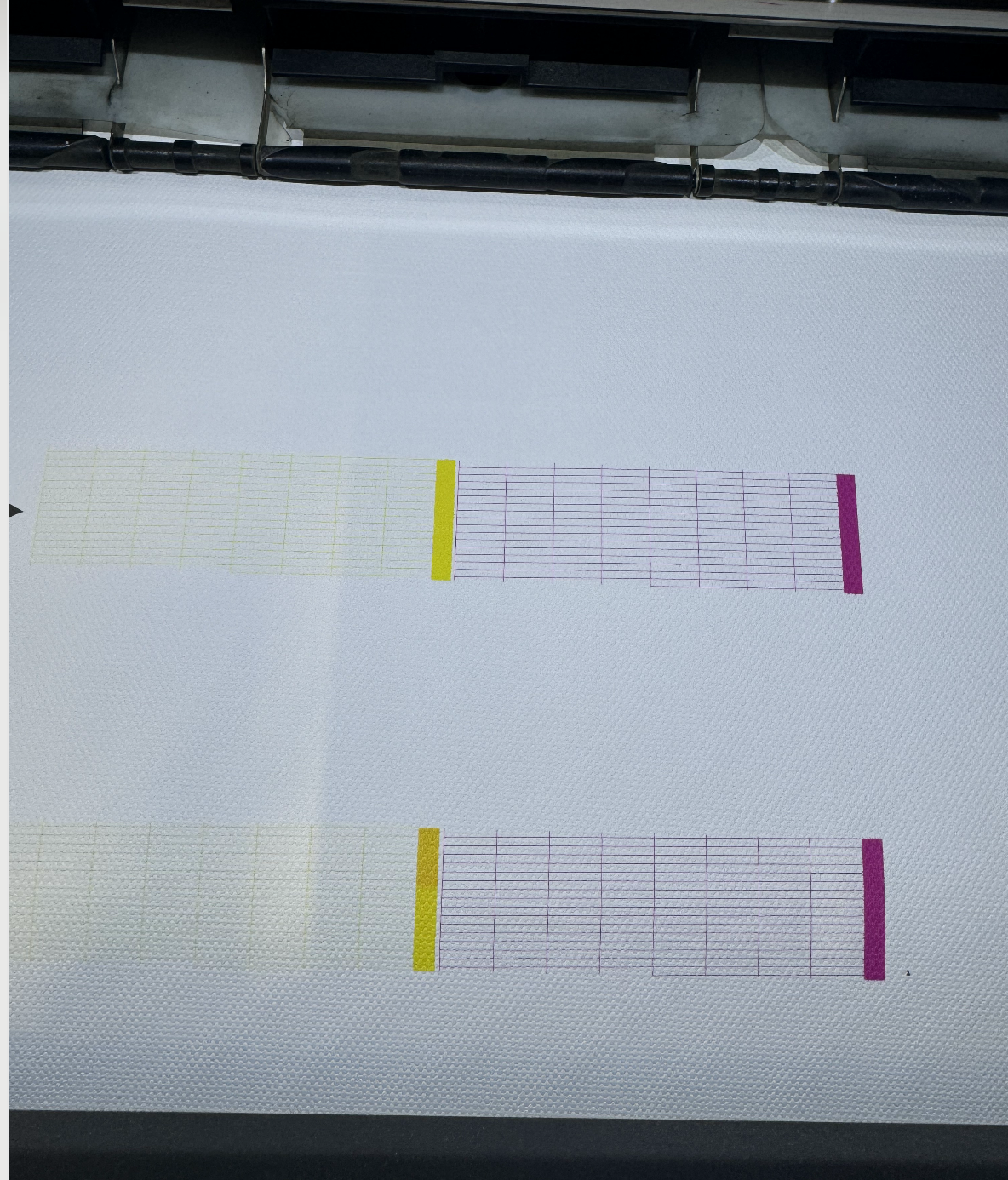

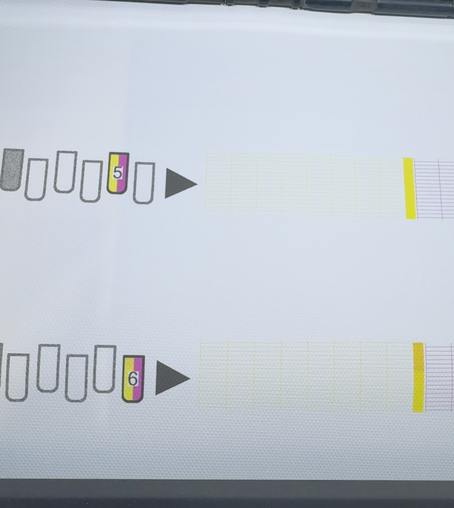

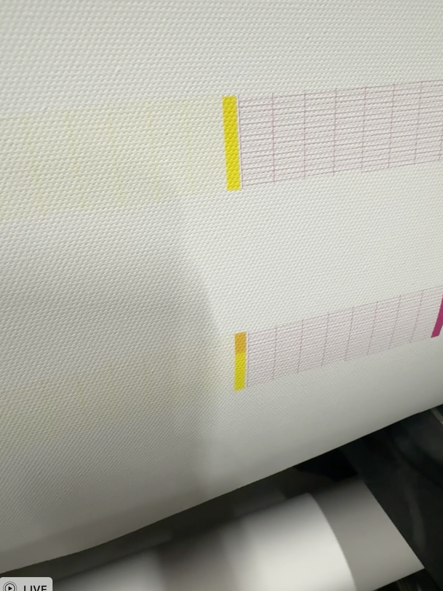

Recently on a couple of printers , when performing the plot tests, we have seen an irregular dark coloured patch in the yellow plots.
The latice / grid of yellow and all other colours is intact, with no breaks, but the solid vertical bar of yellow, has dark mustard colour patches in it.
As i have said, have noticed on 2 printers, and both times on the Yellow ink
Please see the attached plot test, with the dark mustard patch in the yellow vertical bar.
I have cleaned the heads through the print cycle
Forced solid yellow prints with ICC turned off, through the machine a couple of times, in case of a blockage.
And also manually removed, soaked and wiped the yellow / magenta print head.
Another head clean and block of solid yellow forced through, but still the mustard patch on the vertical yellow bar
Please advise ?
The head is out of warranty, but nobody i know replaces them at 1000ml
Its strange this is something that has only happened recently, as we have owned Latex machines for years.
Happened on 2 printers, and it came to light because of colour drop and banding
Bad batch of ink ?
Any suggestions ?
No problem replacing the head, but its strange we havent had this dark mustard colour appear in the banding in all the years of owning latex machines
Look forward to any words of wisdom
thanks a lot
Jack

Check how many jets are out and pray that that's the issue, otherwise you have ink contamination and it's gonna cost bucks.
cornholio
Looks like contamination of magenta into the yellow channel.
Since you have multiple units, you could swap maintenance cartridges to test. I have seen this after SMK3, after a buildup of ink on the maintenance cartridge.
Agree. Also check and clean the rubber wiper blade on the maintenance cartridge (if present). It can collect ink and lead to short-term cross contamination of inks that are delivered from the same printhead.

It looks like it's printhead number 6. replace it and move on. I was told recently that if the printheads are out of warranty, replace them.

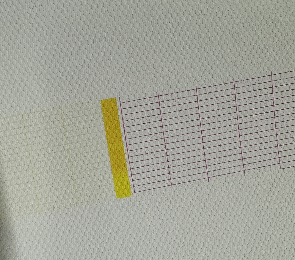

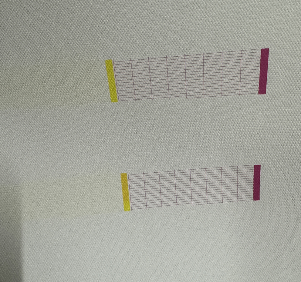

Hi, thanks for the info, much appreciated. Could you show me a pic of where this wiper blade is please . We have just replaced a maintenance cart, as we had this similar problem again recently ( see attached photos ). If you have a photo of the wiper blade to clean please and i will check it on the cartridge we recently replaced which was 97% full . Thanks very much

I've chased things like this a few times. Always comes down to printhead or maintenance cartridge. Usually printhead.

Had the exact problem last week, replace head #6 and move on, not worth your time to keep on working with the printhead.
