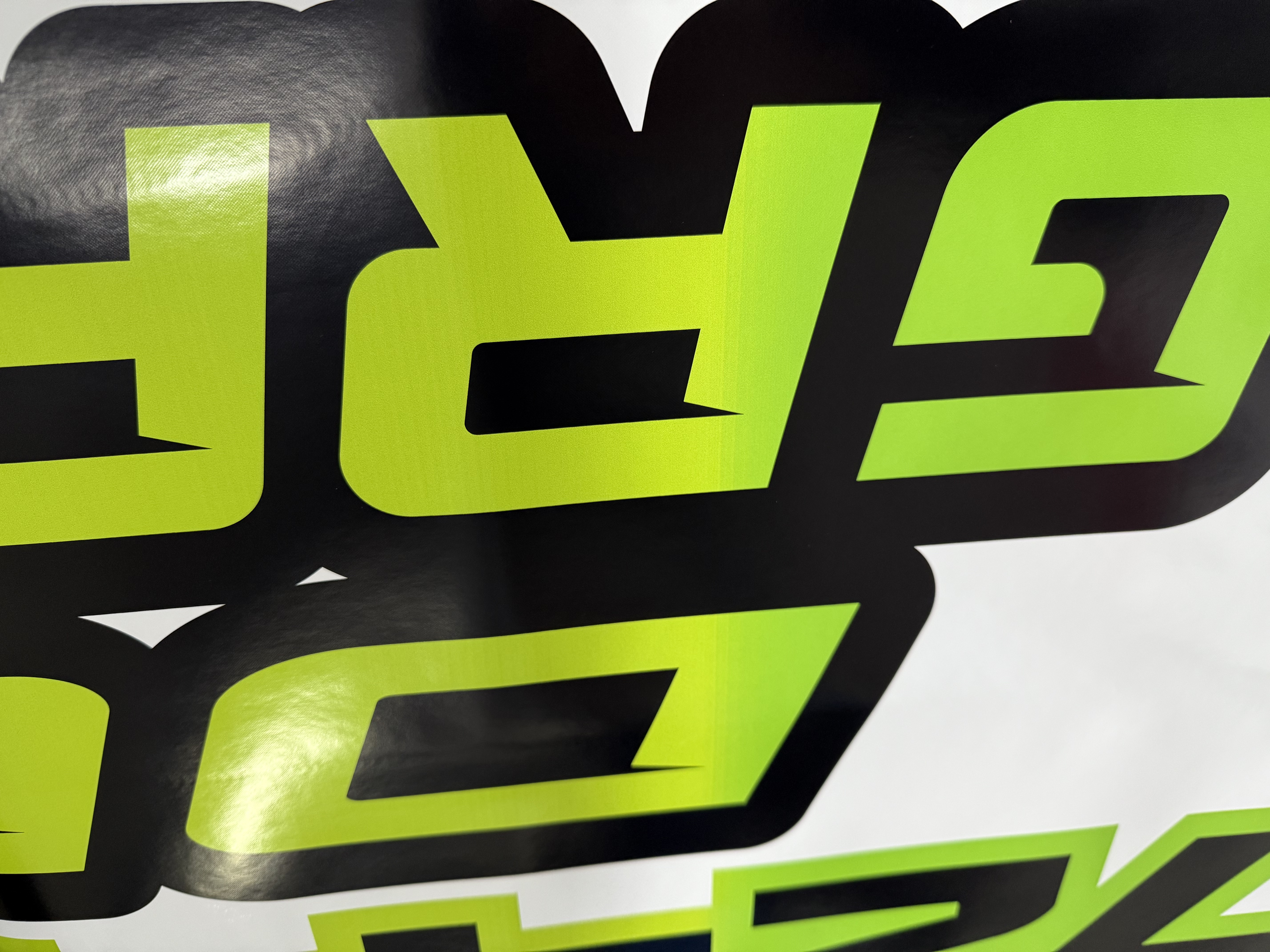

I have a latex 335 that we just got up and going again after being down for a month or so. It was printing about 60' of banner material perfect and I just went to print some vinyl and it started out good and then the green started printing into a yellowish color. I did a printhead clean and did a test and it was coming back fine but does this seem like a print head issue? It has all new yellow and optimizer print heads but wanted to make sure before I bought anymore since the test seems fine.

I recently had an issue with my printer (hp315). Both yellow/magenta printheads had a bunch of nozzels out and they were in warranty. I called HP and they sent me new ones.
