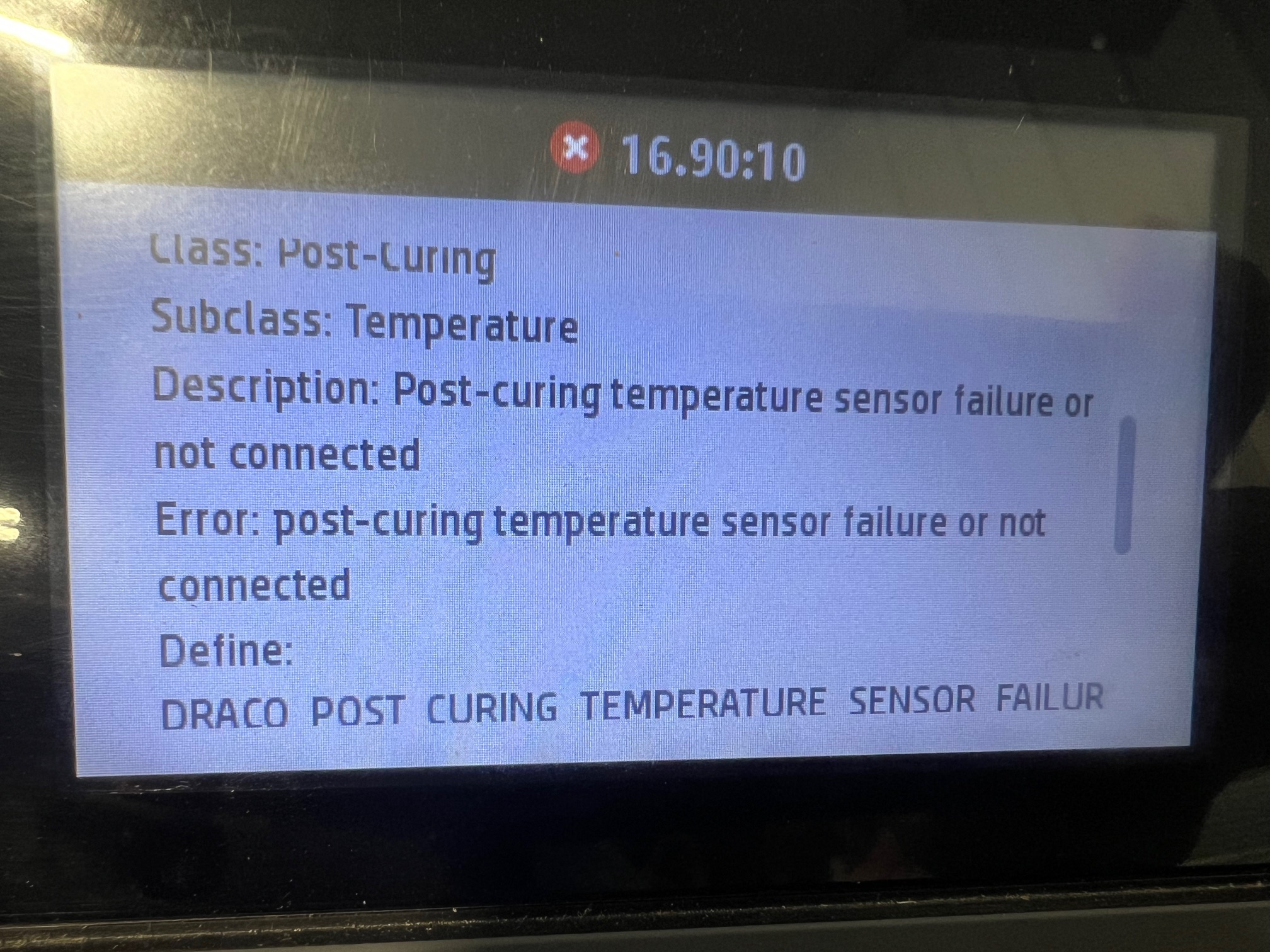

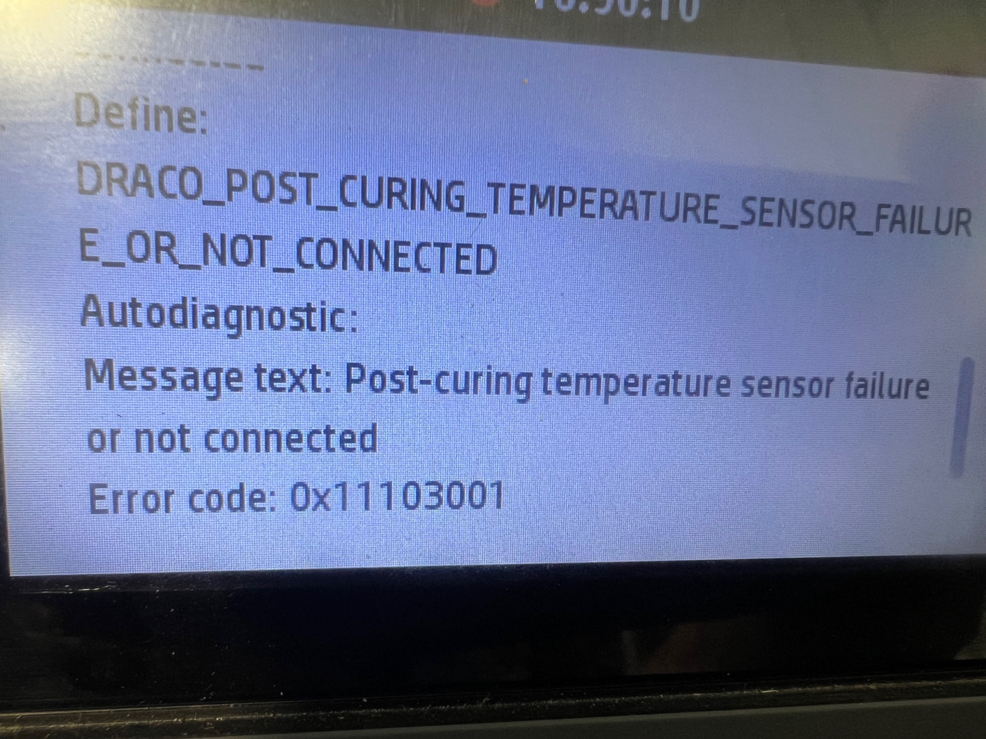

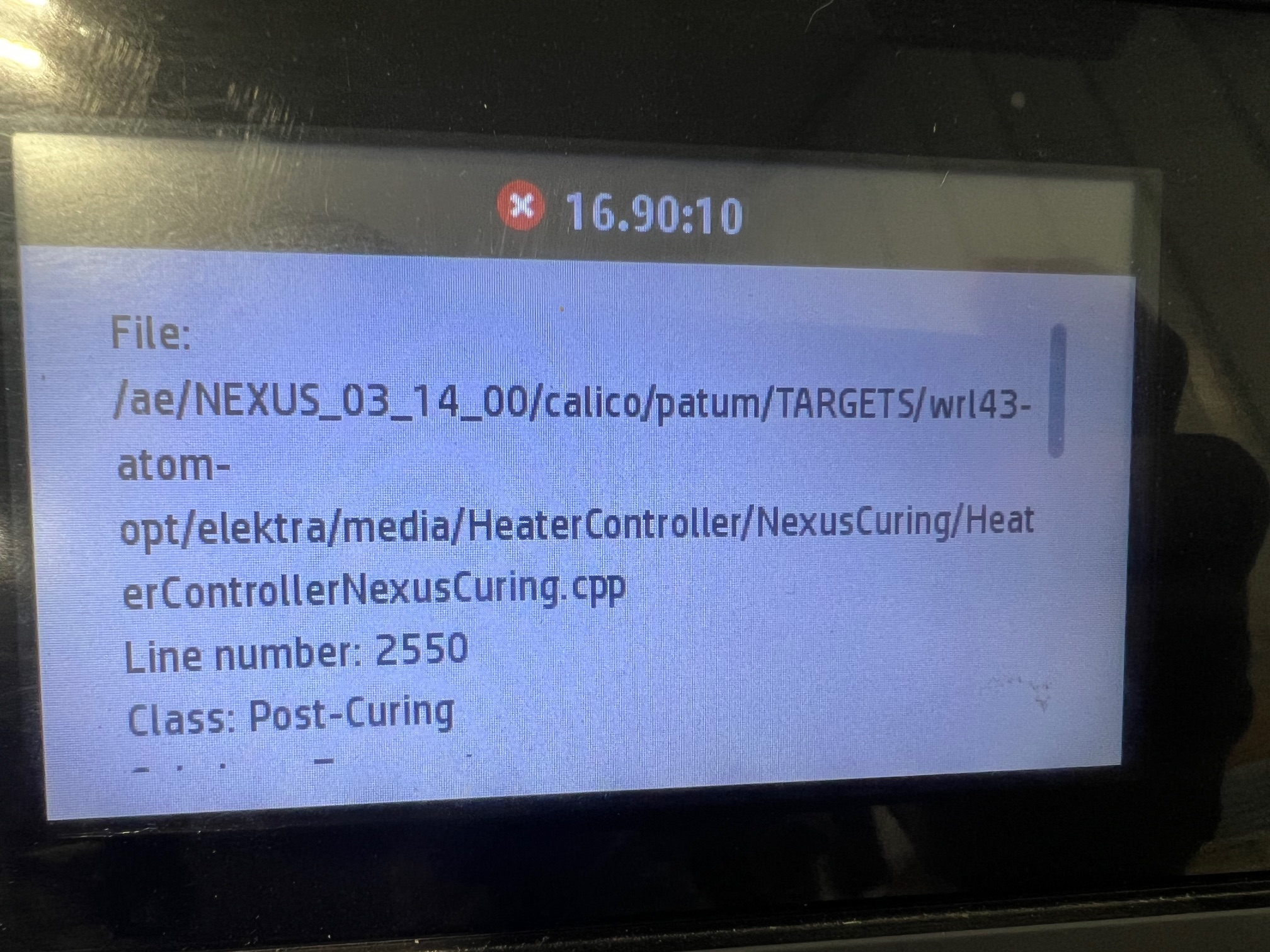

I unplugged my printer due to a storm coming and hoping to not have an issue. When I went to go plug it back in I now have this issue.
I tried swapping the plugs to the outlets Tried countless resets I feel like it something stupid but I can't figure it out. Any input on this would be greatly appreciated.

You are going to have to investigate the post curing temp sensor.
Probably just a bad connection. You likely moved the unit to pull the cords and it happened.

Thank you I will pull off the rear panel and see if anything looks odd or disconnected.
