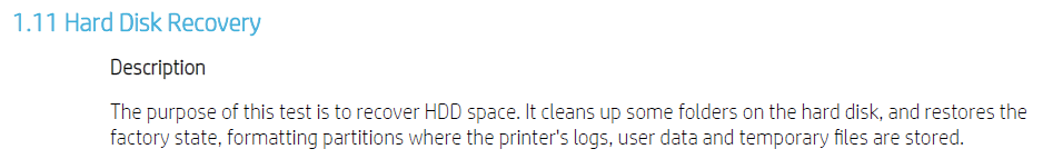

You have to run a "disk recovery" from diagnostic. Usually you can update firmware after that with no problem.
We are about to try the USB option, but in case that doesn't work, I found Service Menu>Service Utilities>Hard Disk Recovery>Unsecured Hard Disk Erase. Is this the correct option? Sounds pretty drastic, but if that is the only way, we will try it. Just making sure we are choosing the correct option.

We just tried the USB option that FrankW suggested and it notices the USB and downloads the firmware, then tells you to remove the USB. A few seconds later we get an error code that the firmware on the flash drive was not a valid firmware file. It seems to be the same basic problem we have with every other method. Our 360 doesn't seem to have a "diagnostic" menu, as balstestrat said, but I found Service Menu>Service Utilities>Hard Disk Recovery>Unsecured Hard Disk Erase. Before I take what seems like a dangerous step, is this the correct way to do a disk recovery?

The disk recovery trick worked! Thanks to balstestrat for suggesting it!! Thanks also to FrankW for the steps for the USB option - we may need that down the road.

I know this is a little old, but I'm having the same exact issues with firmware update. I'm very hesitant to do the disc recovery. Did you have to reload all profiles after you did that?

No it just removes some temp files. You won't lose anything.
I've done it many times.

I’m also having the same issue. So you selected the hard disk erase? Like everyone else I’m nervous about selecting that option

Yep just select that. It only removes some temp files. All good.
