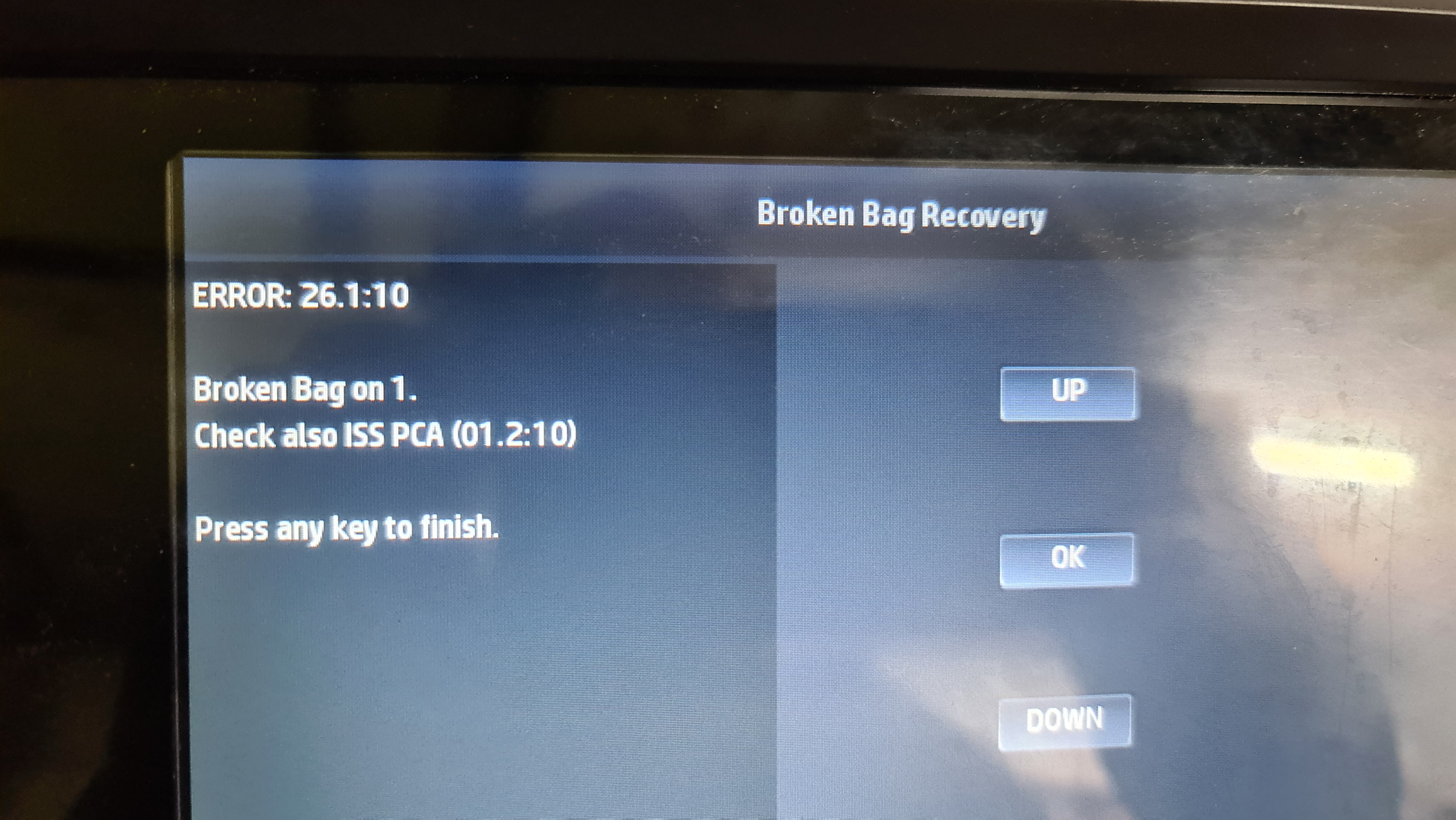

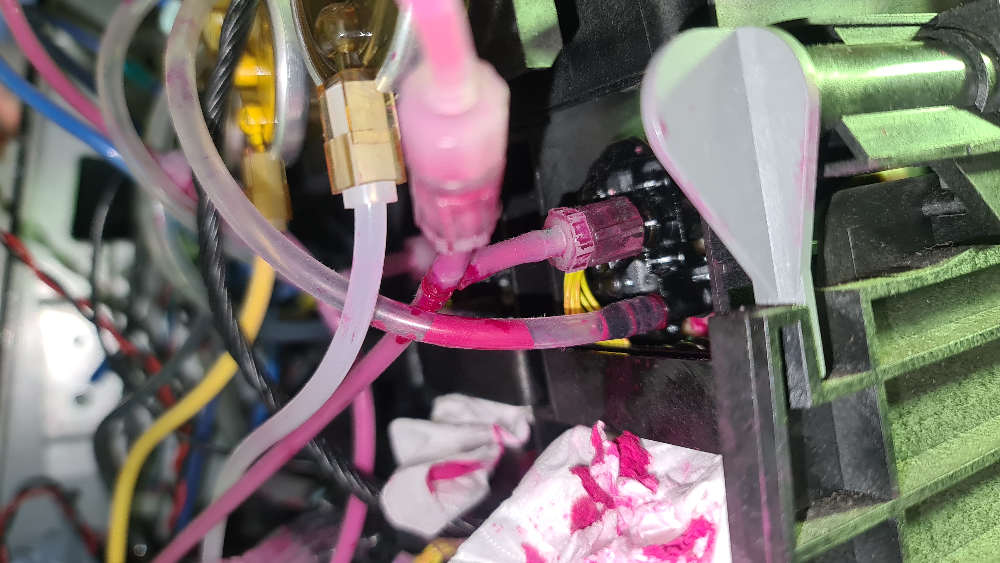

The printer shows error code 26.01:10, Ink leakage detected in Magenta supply and the ink is into the air tube.
the magenta ink cartridge looks ok. That magenta PIP must fail.

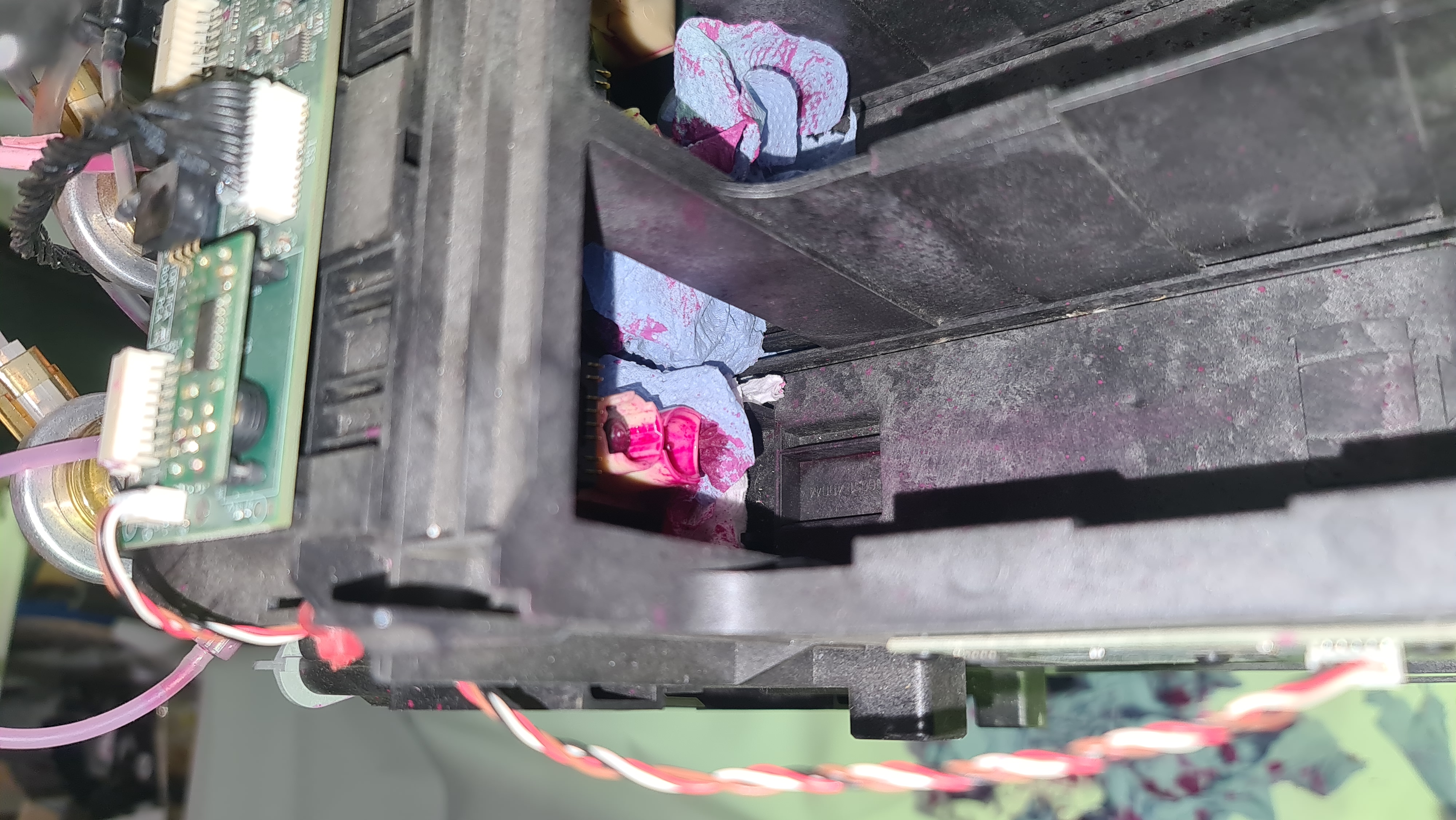

1 . Can the PIP be recovered or repaired please? why will it fail? I open it, some ink inside it. Will it work again if I air-blow and dry it?

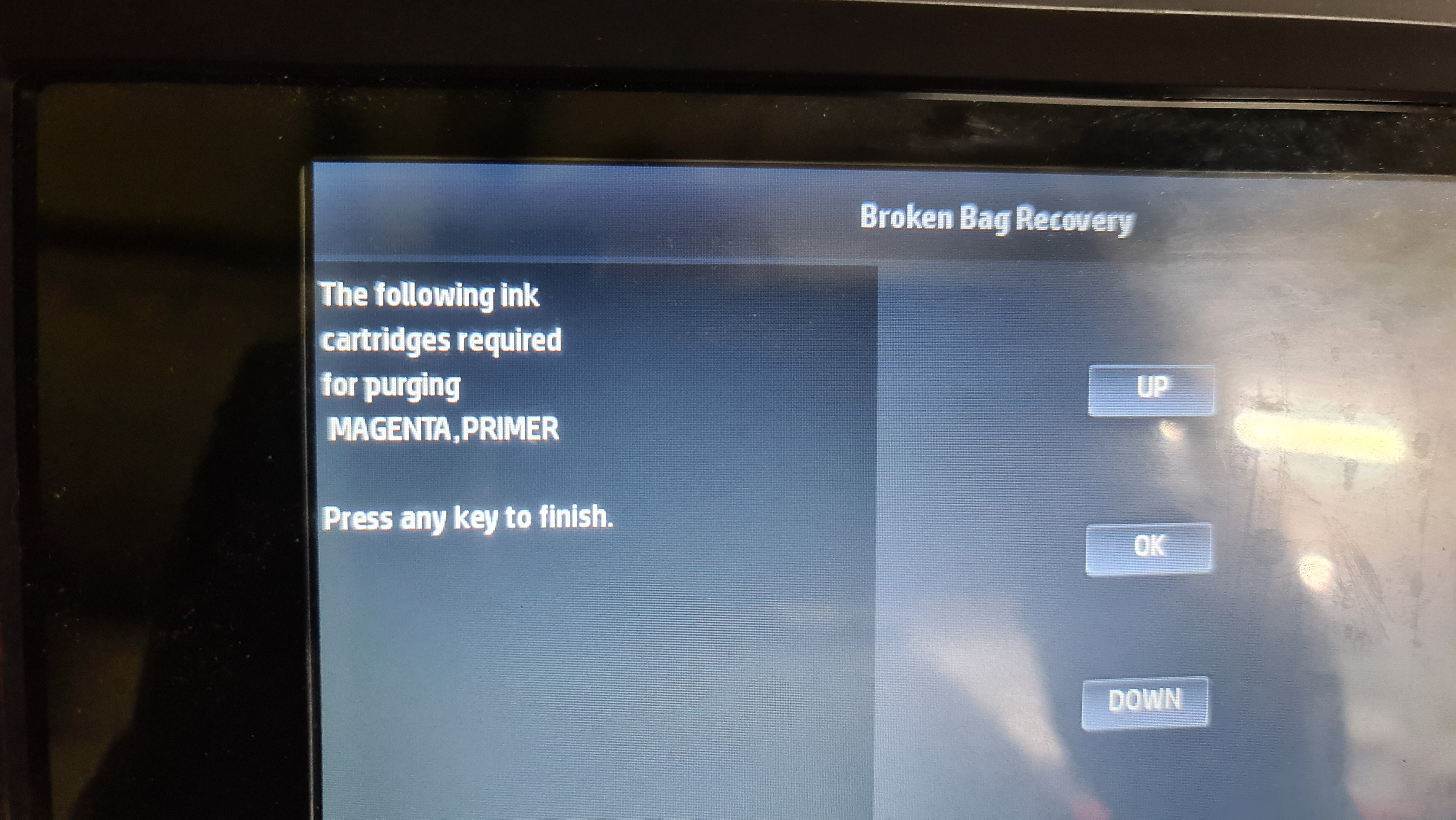

2. after I install a different colour PIP from the spare printer into the magenta slot, What is the next correct process? according to the menu, Clean Air Tubes->Recover Broken bag->Refill Ink Tubes

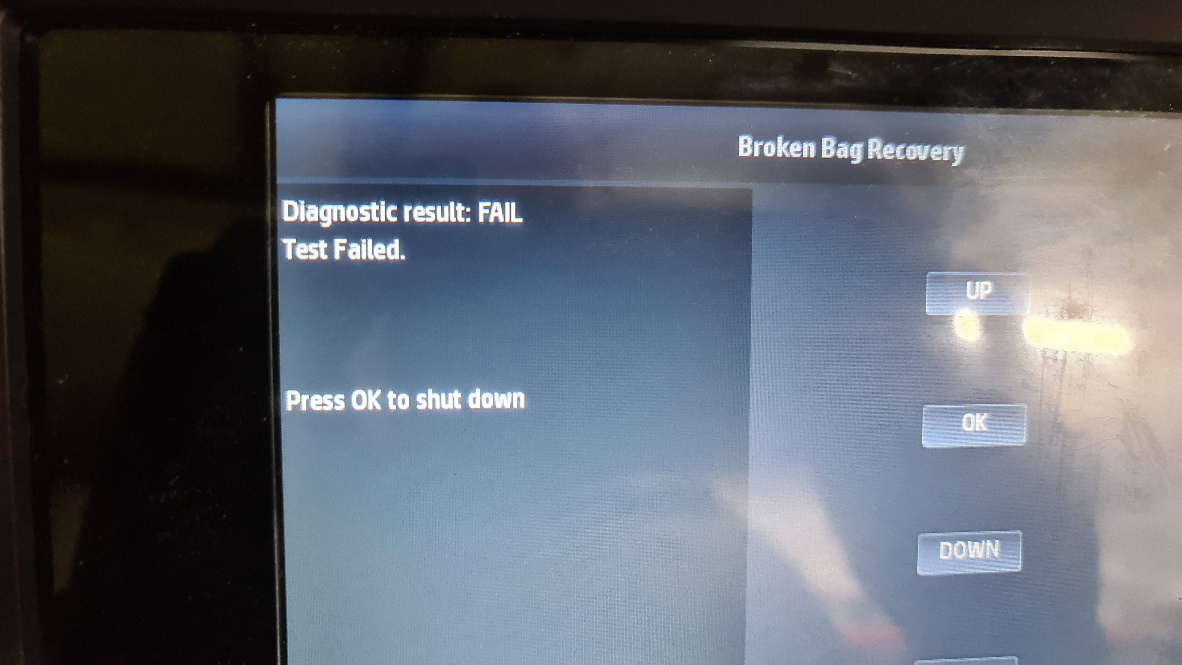

3. I got same error code after I switched a PIP, does that mean that PIP is a faulty one also?

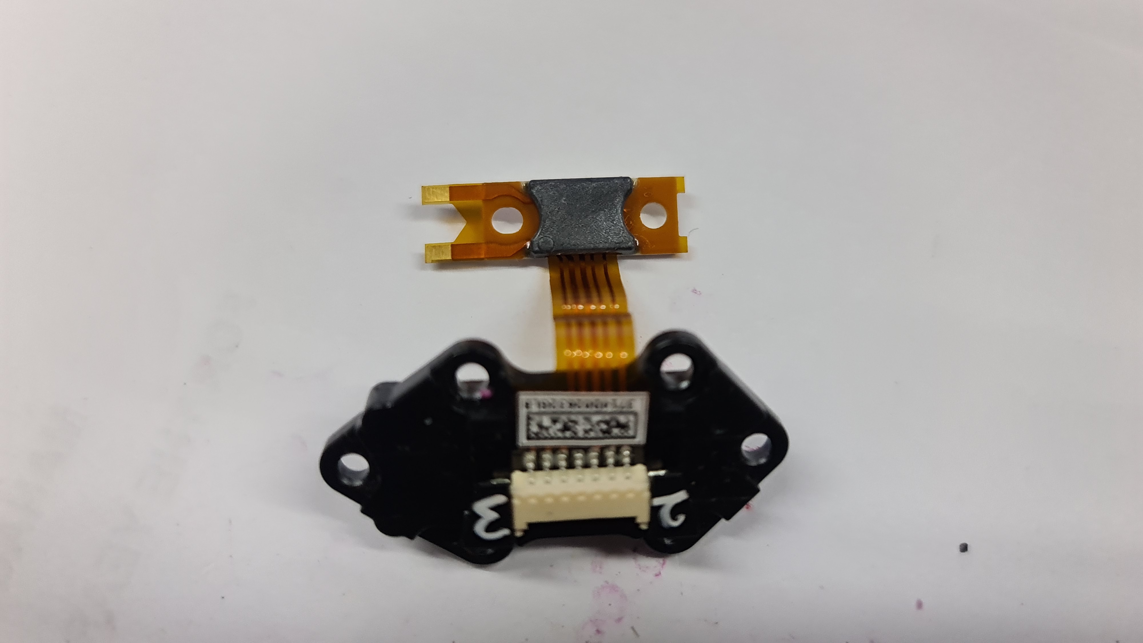

4. about the Ink-Level Sensors Calibration, I don't know the value(10 digits) for the new PIP, how should I pass this step?
