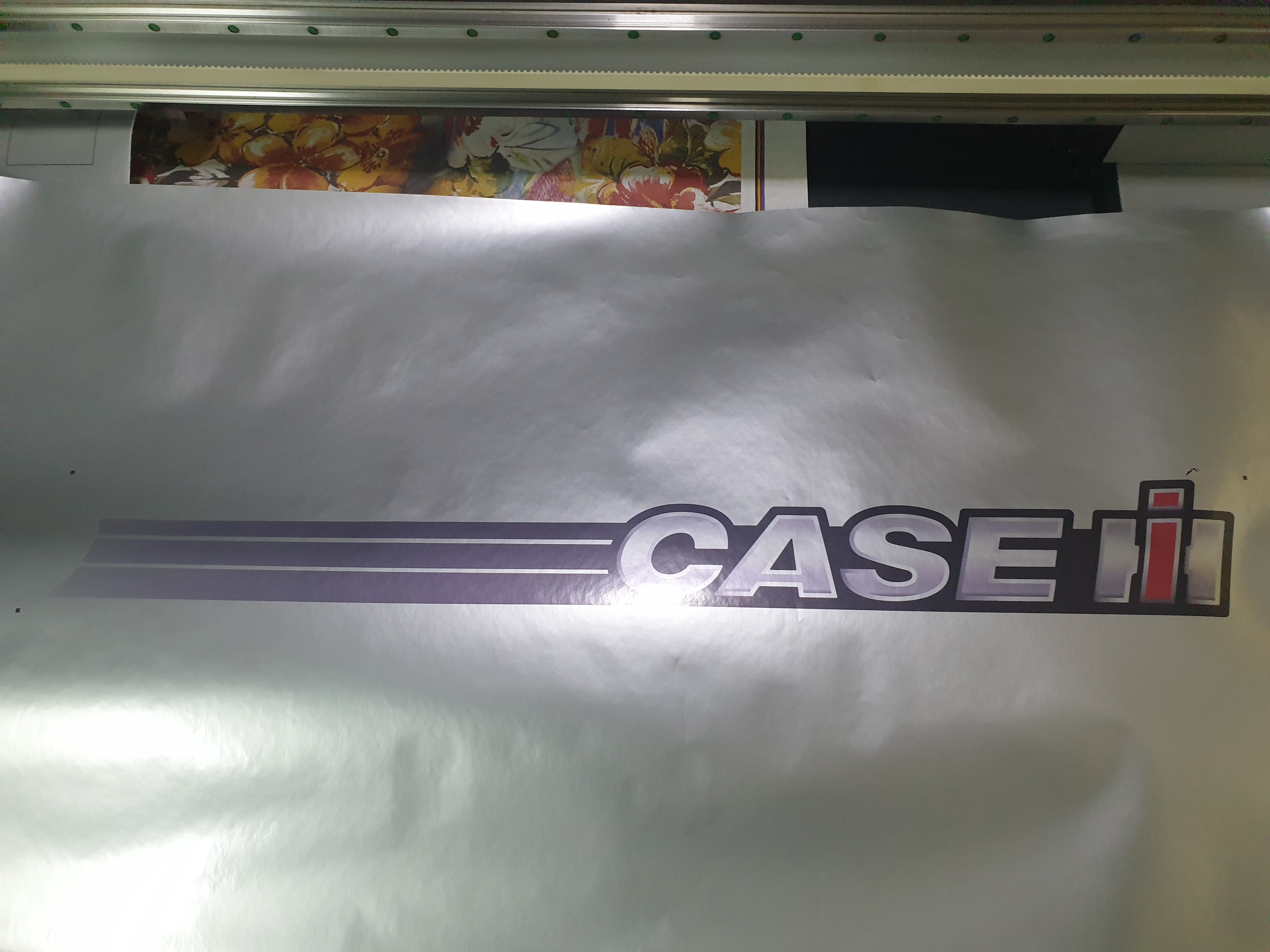

I have a Hp Latex 315 with a Hp cut 54. I have been using them mostly for sticker making. A client has asked for a sticker on a glossy grey self-adhesive vinyl but Opos can't sense the barcode printed on the media. I tried OposX and OposXY modes too but same problem, can't sense the marks.
Calibrated the printer for the media(ICC etc.) but couldn't calibrate the cutter. Cal Media can not be completed with the message on the screen. "This media can not be sensed with Opos. Yellow too light."

Thx for your response. This might work for small jobs but the picture I added was just to show the vinyl. I have to make 500 of those, it would take a life time that way.
