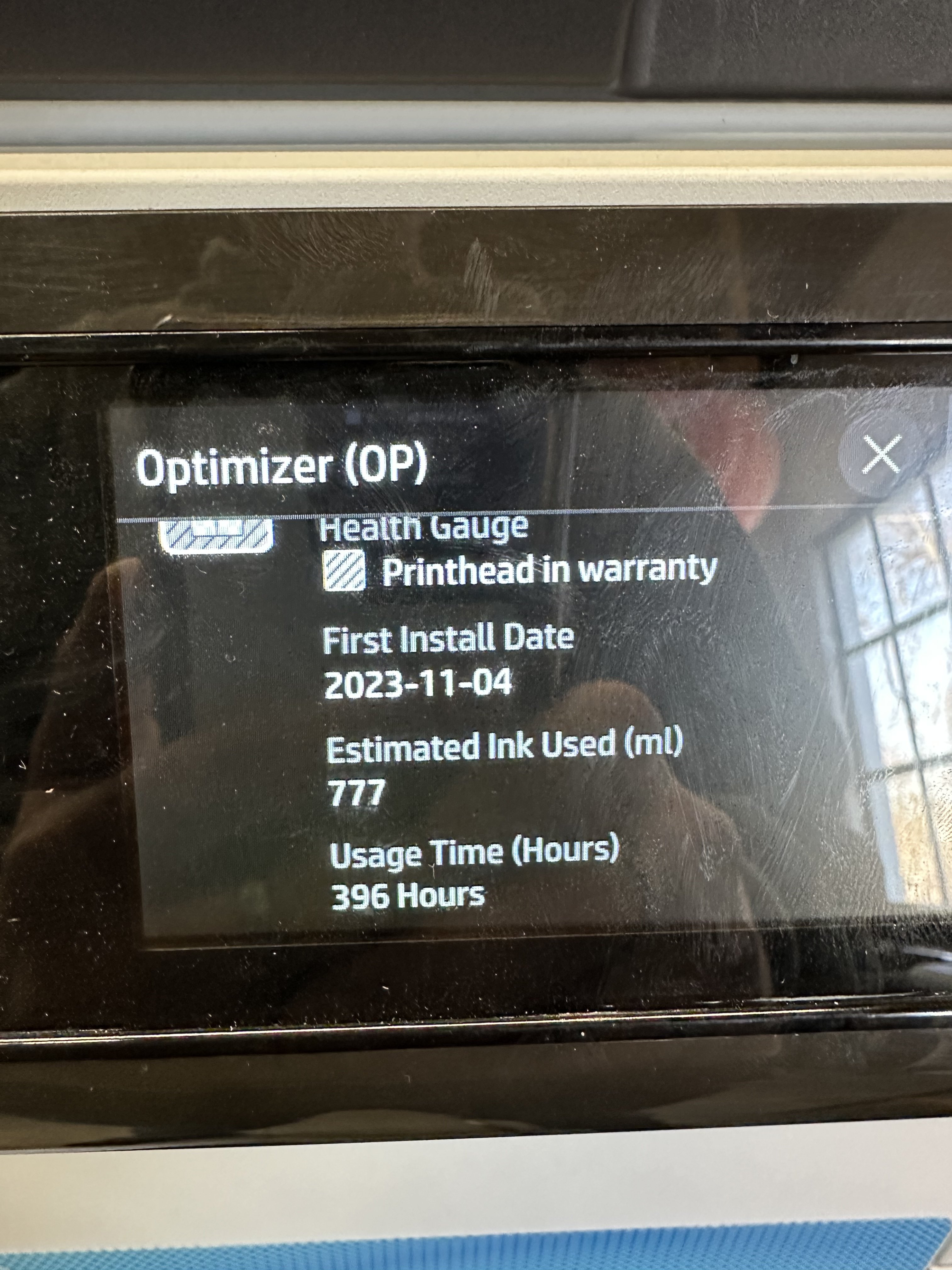

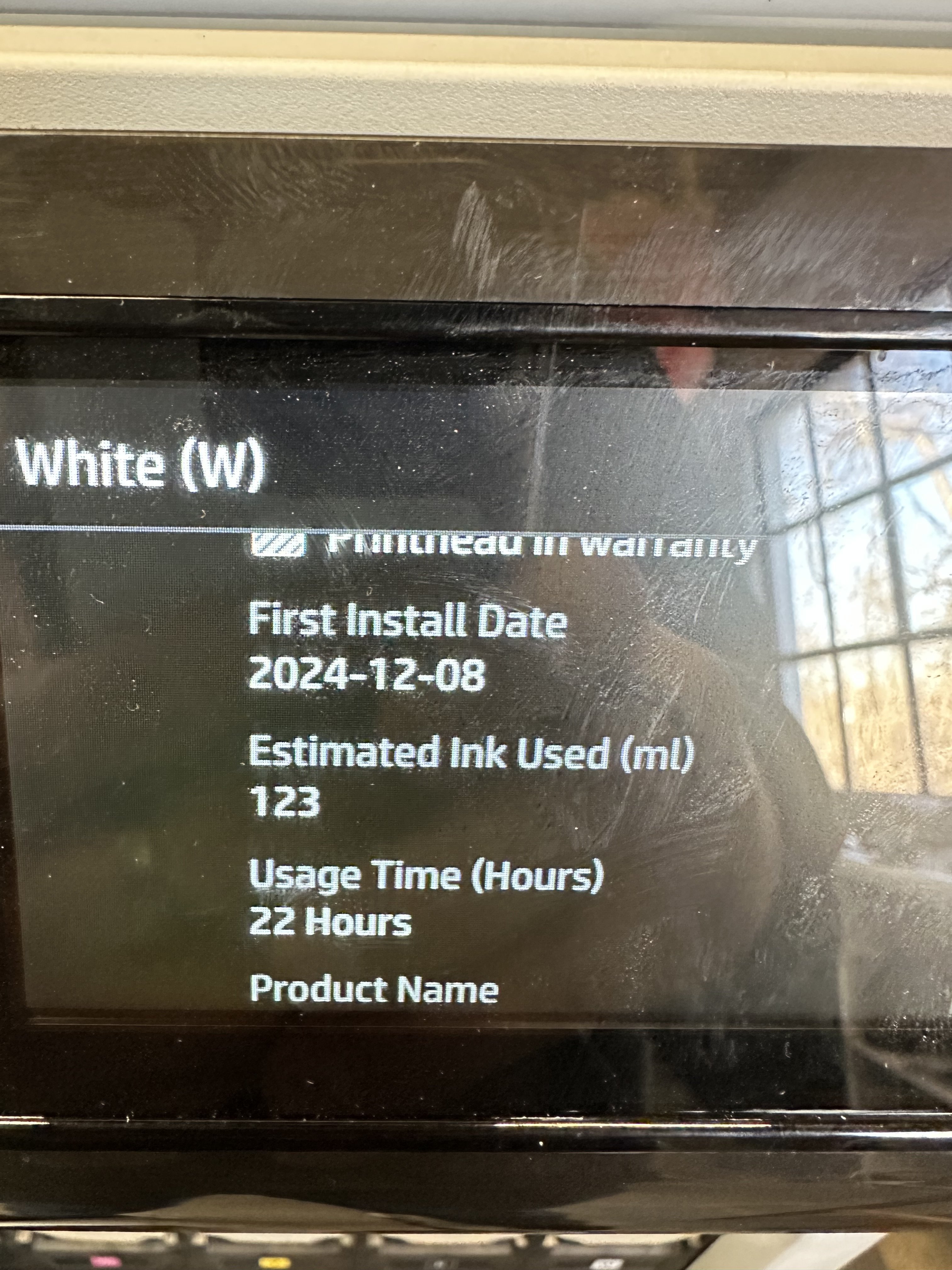

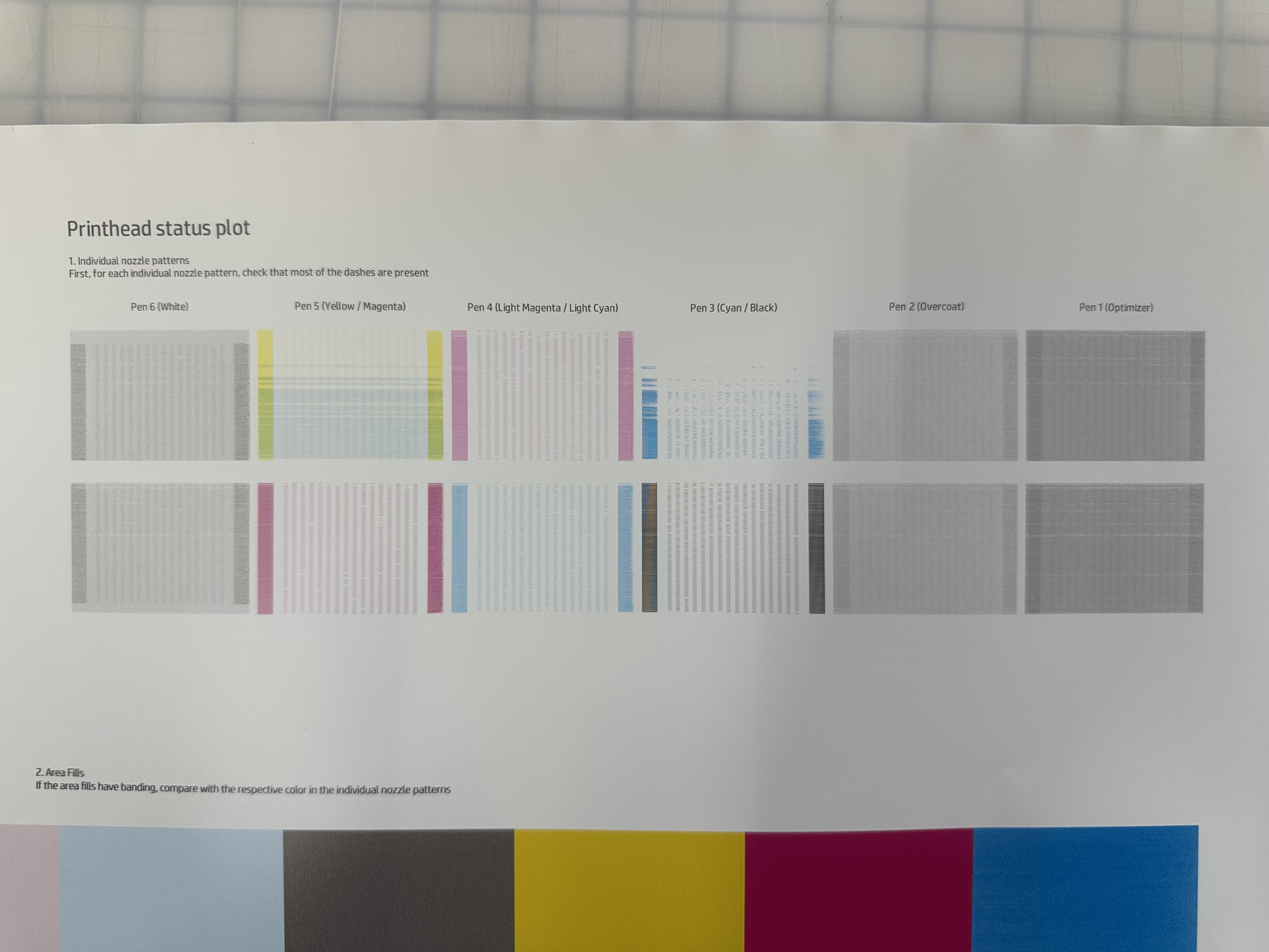

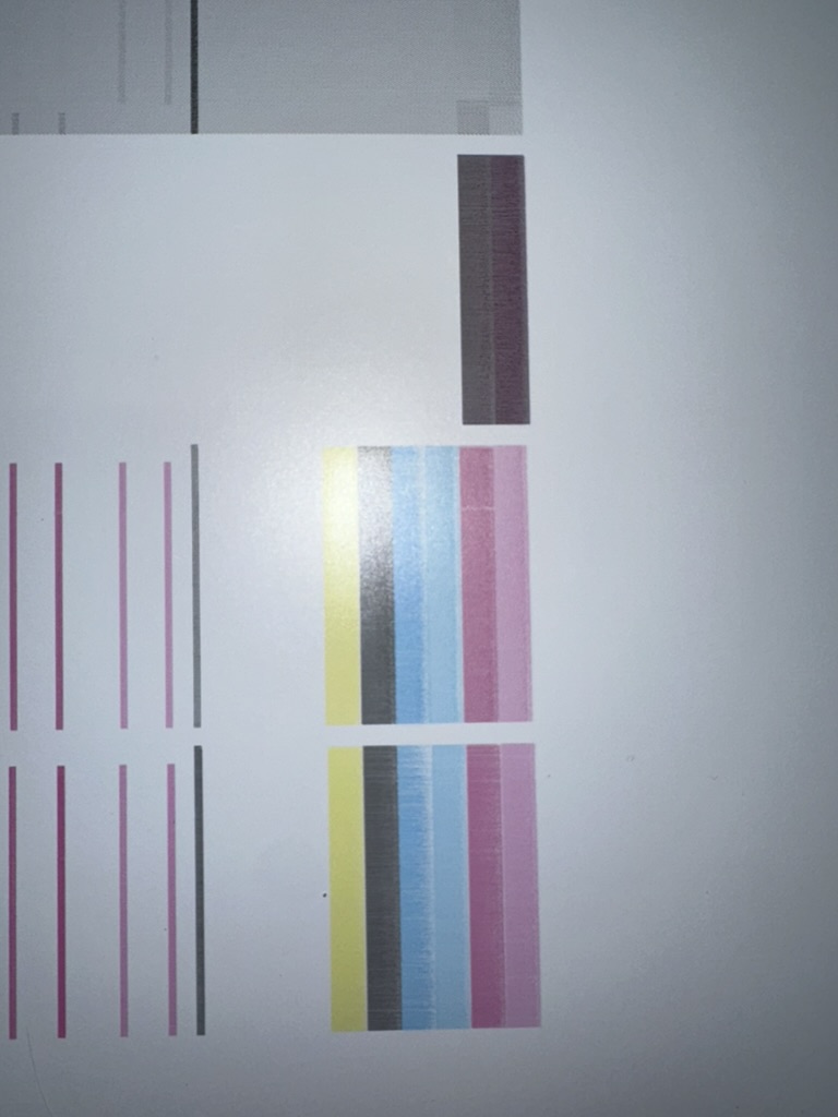

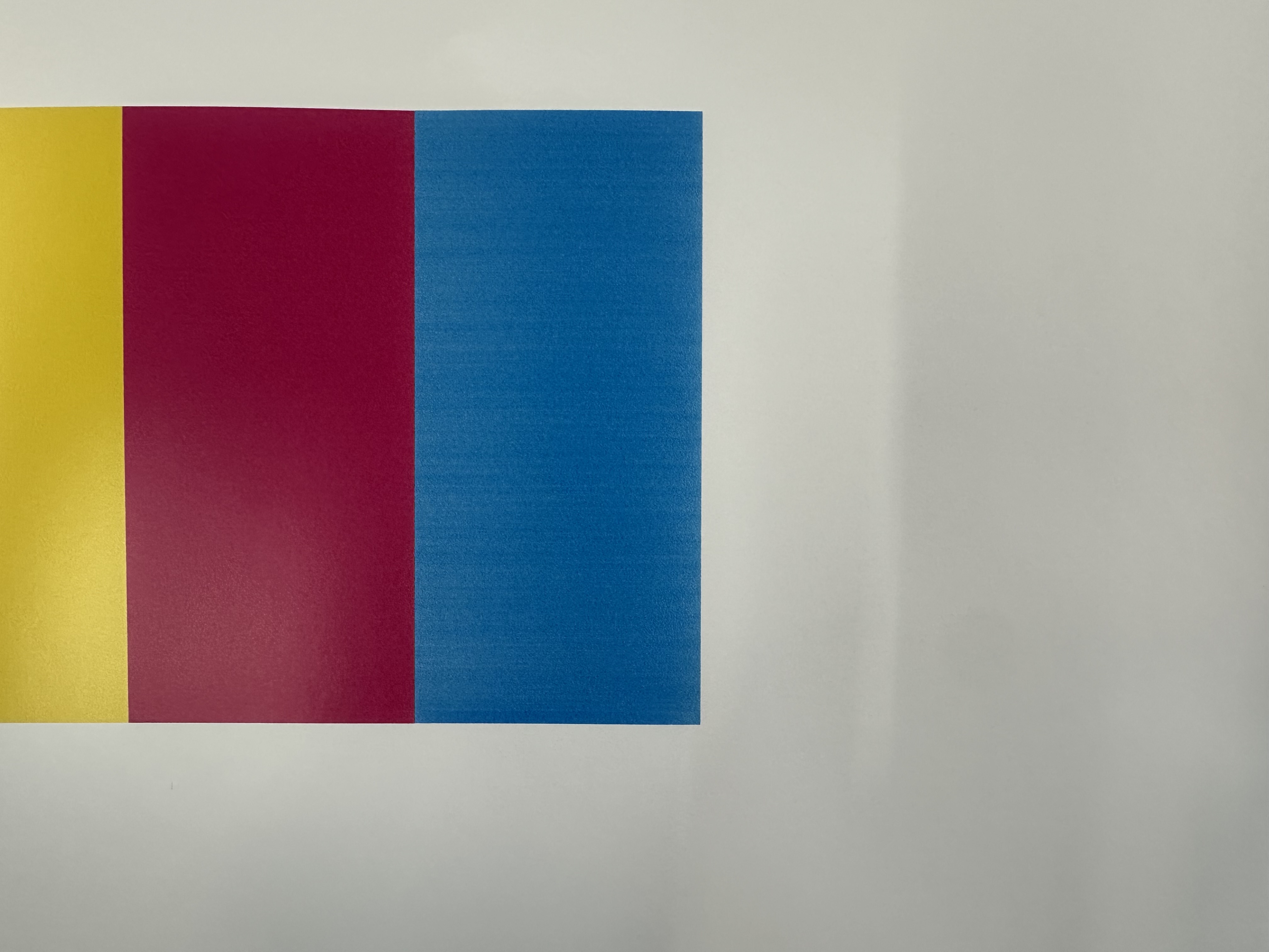

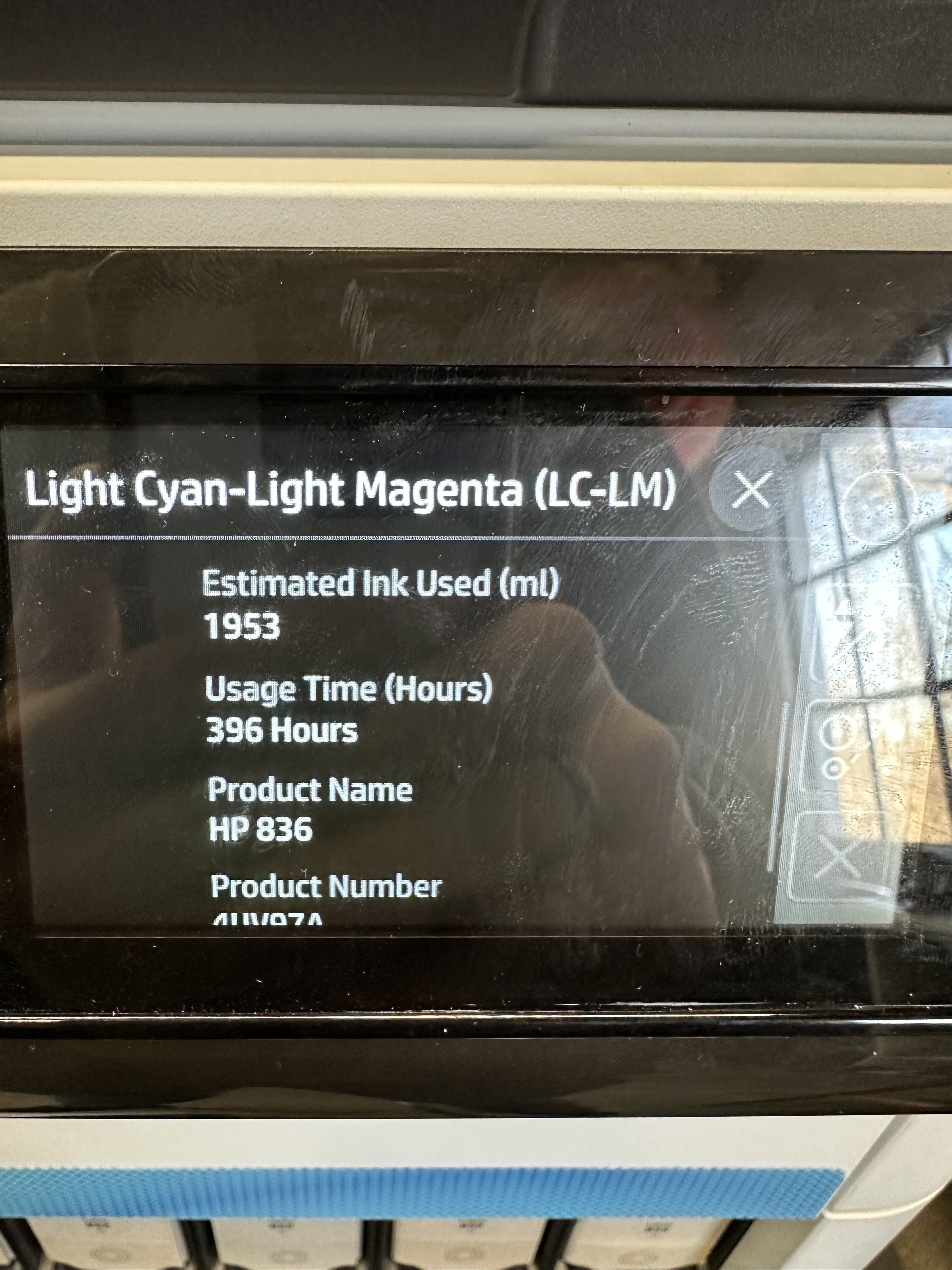

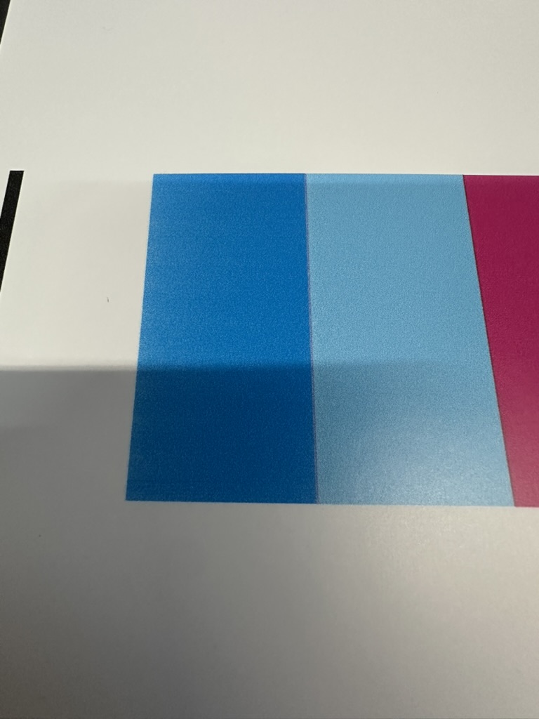

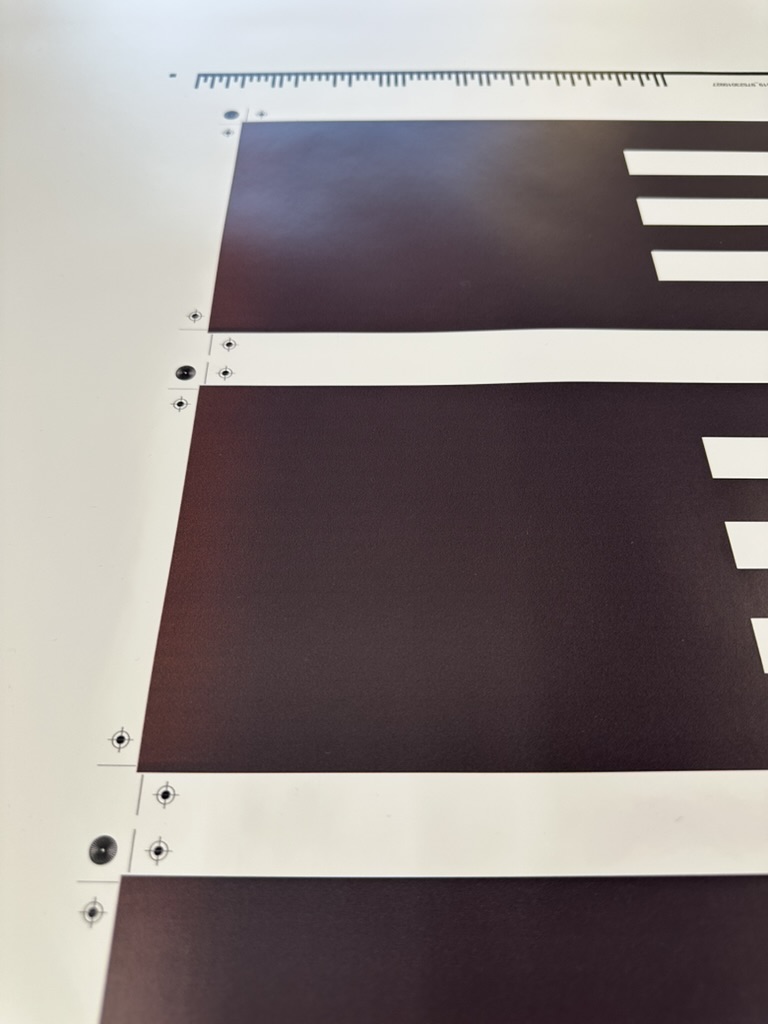

Hey all. new to this forum but always have come here for help and see how active the community is so hopefully some have you know whats going on here. Recently after a printhead change or calibration i forget exactly what the circumstances were... wheni print greys the left most edge only on the last inch prints pink as if cyan is dropping out. it doesn't matter where the last inch of the grey is it happens wherever the printed are stops on the left. i will attach pics. Cyan cartridge is brand new and i know i have some nozzles out on my print heads but all seems like it should be running within spec. let me know if you have experienced this. ive run all the calibrations and tests.

How many ml are thru your print heads? Can you print out a Print Head Status Plot and post close up pictures of each of the heads?
To check the usage on the print head go to Menu > Supplies > Print Heads > Select The Print Head you wish to view > Scroll down to Estimated Ink Used(ml)
To Print a Print Head Status Plot go to Menu > Tools > Troubleshooting > 3 Dot Button in bottom Left > Select Print a Printhead Status Plot.

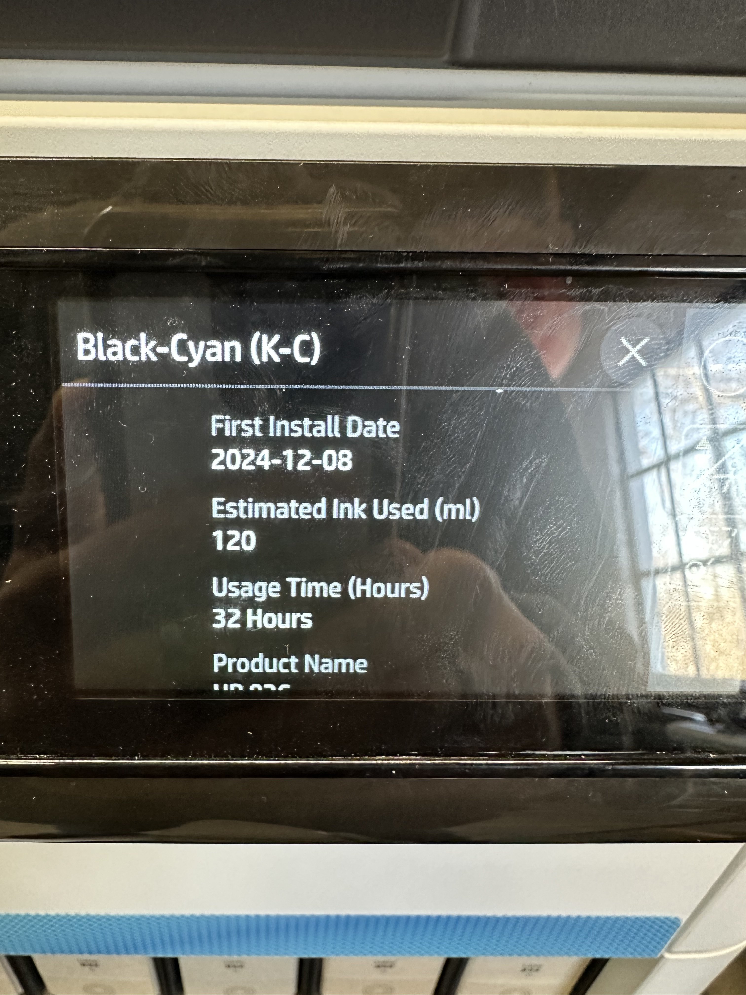

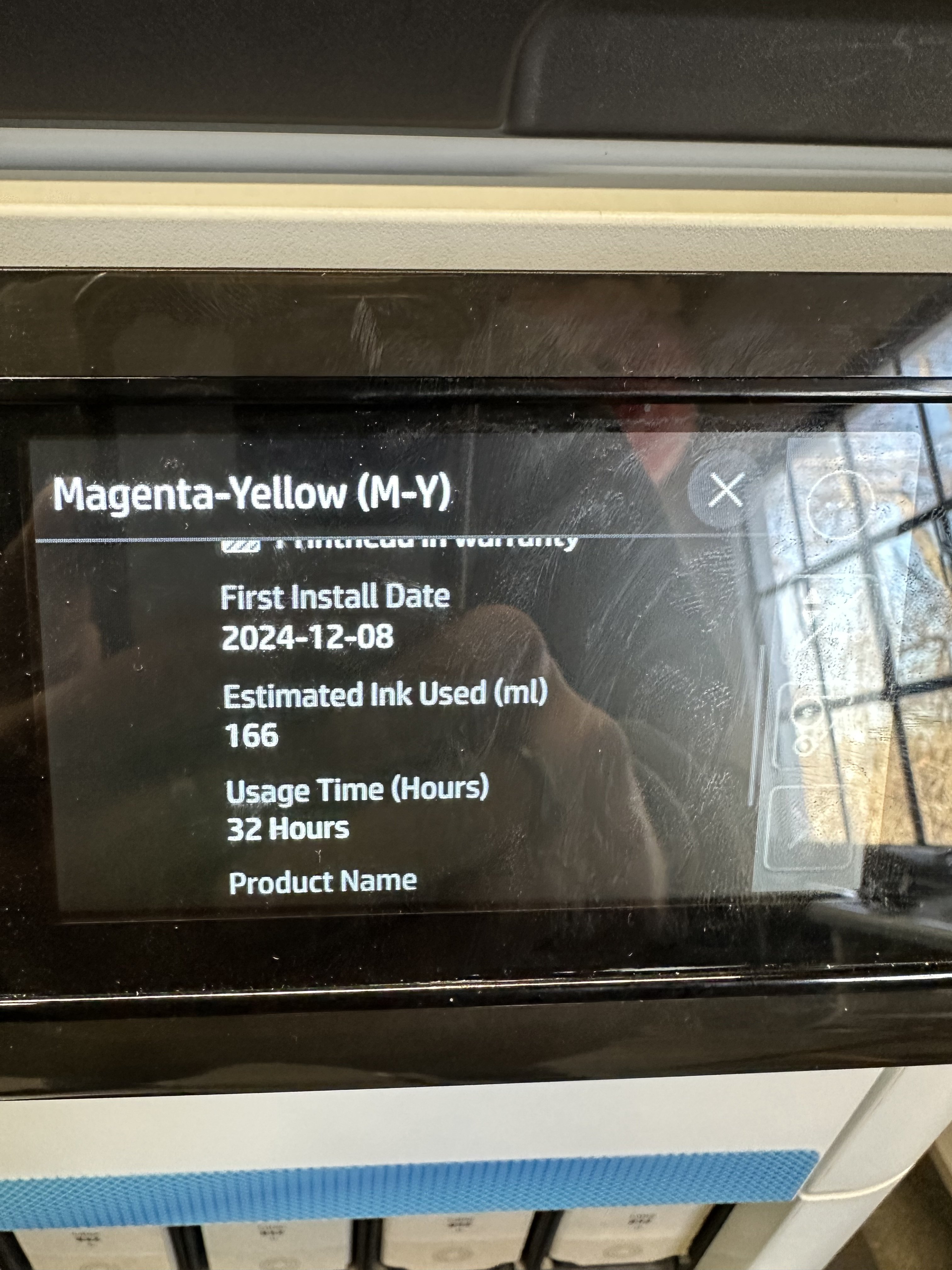

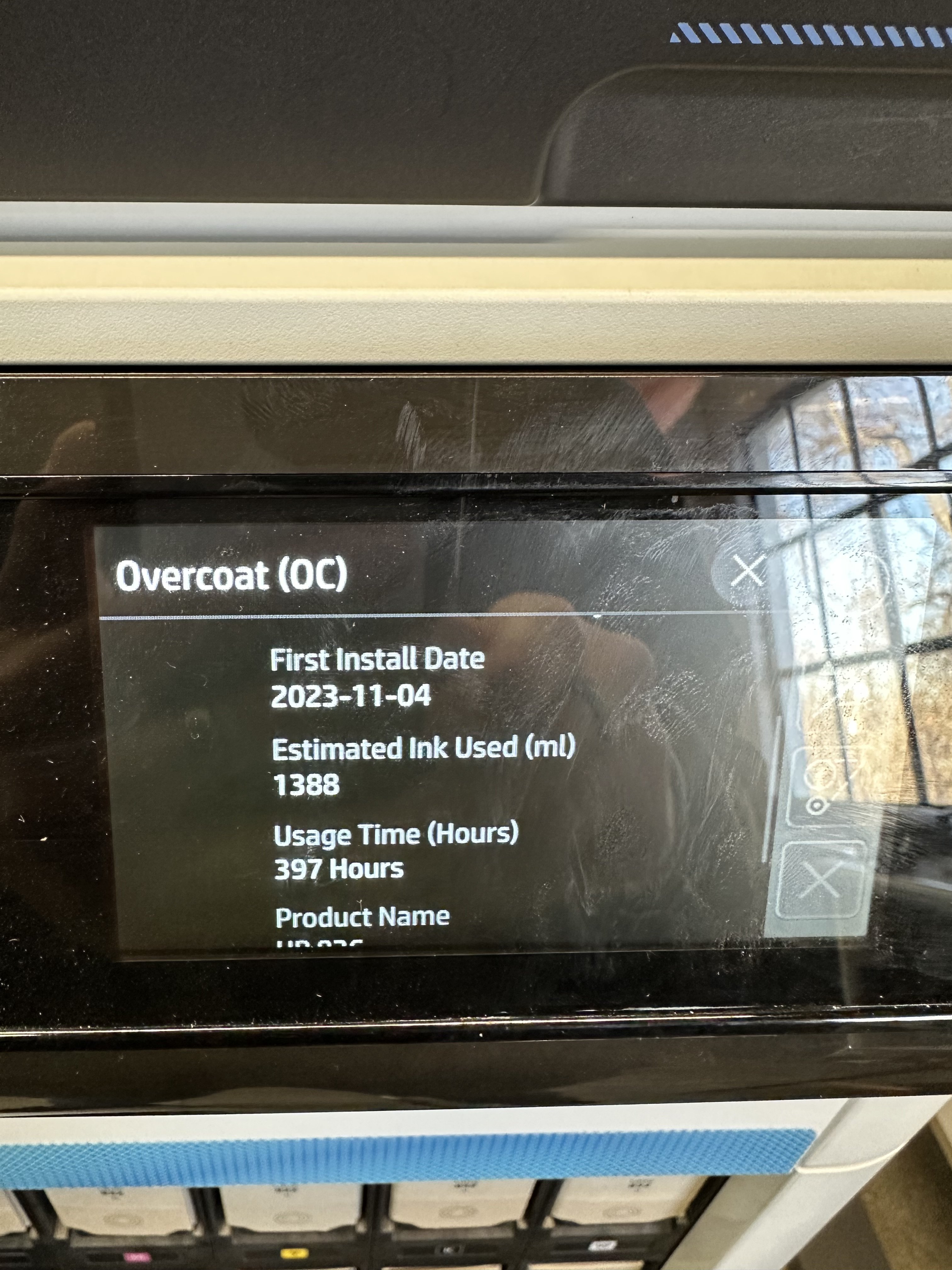

Of course i just ran out of overcoat and don't have one as a back up so i cant print the plot but here are the print heads,
