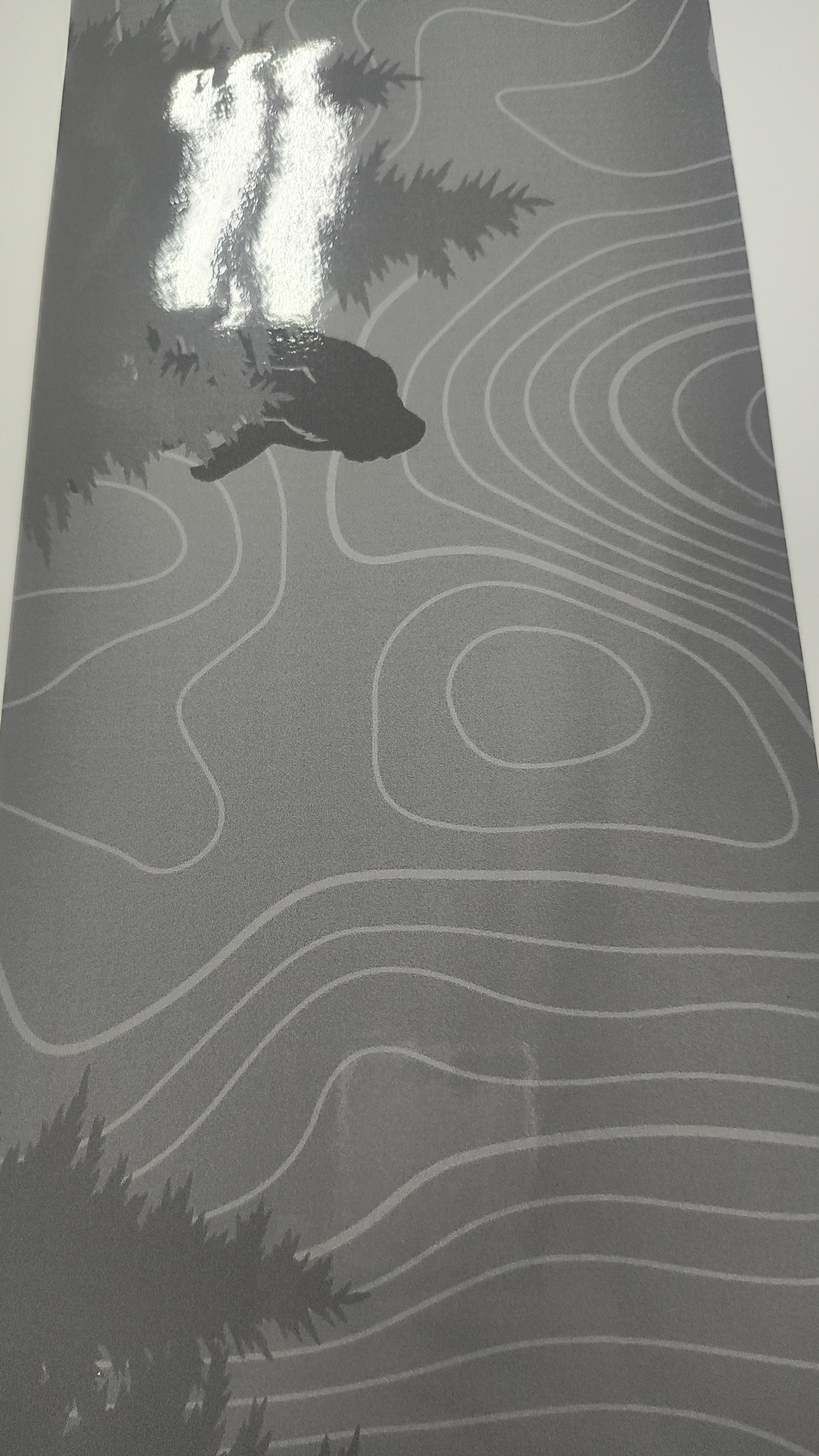

Hello, the shop I work for is attempting to switch from printing complex vehicle wraps (i.e. corners and crevasses) on 180mc with our Oce Colorado to 480mc on our HP R2000 (trying to get the prints to be more flexible). I've been running into a ton of issues with color matching and ink gamut. I've tried everything I can think of like increasing the pass count and dpi, white under floods, custom media profiles, even switching back to the Colorado. Unfortunately, nothing helps. The spot colors are way off and there is a graininess to all of our images. I'm assuming the issue lies in the fact that the HP cannot saturate the substrate enough even at 600dpi but why does the issue still persist on the Colorado which prints at 800 and higher? I need help. We have just purchased an Epson s80600 and I know solvent based ink will most likely solve the problem but that won't be installed for a few weeks. Does anyone have any prior experience with running this material on an Hp and if so, do you have any tips? (I'm using onyx 2022 btw). Thanks.
