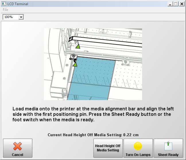

FrankW
Yes, "Head Height off Media" ist what I have looked for.
