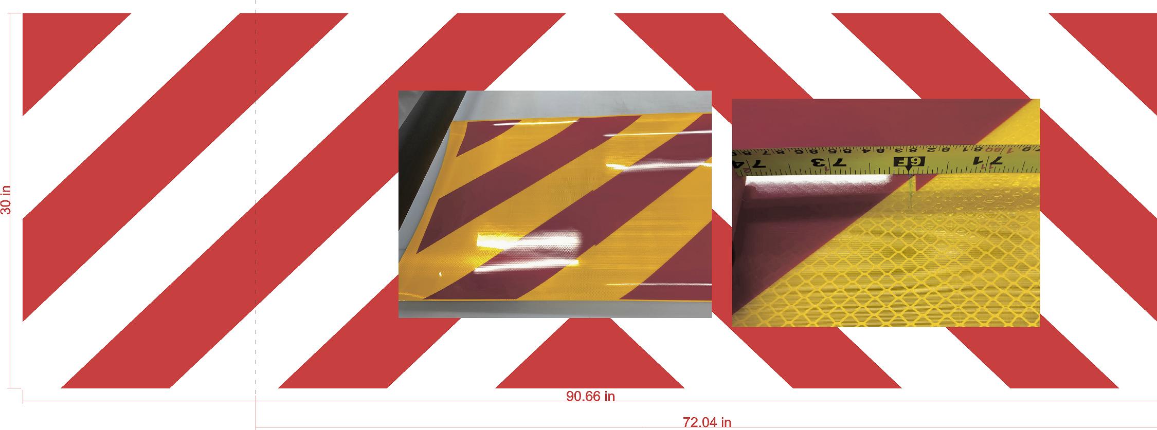

I've been running this 365 for about a year, after 40 years of running every other thing!...using Flexi Traffic v21, thru their Production Mangler. Most prints are fine, even 200mB images.... 20' long!
Then once in a while, a very simple image (like this chevron fire truck panel) runs fine for 6' or so, then decides to magically jog over 1/4".
Anyone else seeing this kind of BS?
obviously reprinting on diamond grade reflective is painful in several ways!...not knowing if it will do it again???
any ideas welcome!

contact flexi and have them trouble shoot it. I had a problem like this a few years ago after they did an upgrade. Turnsout there was a bug in the upgrade that they had to create a patch /workaround for.
