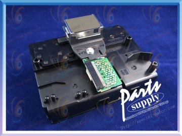

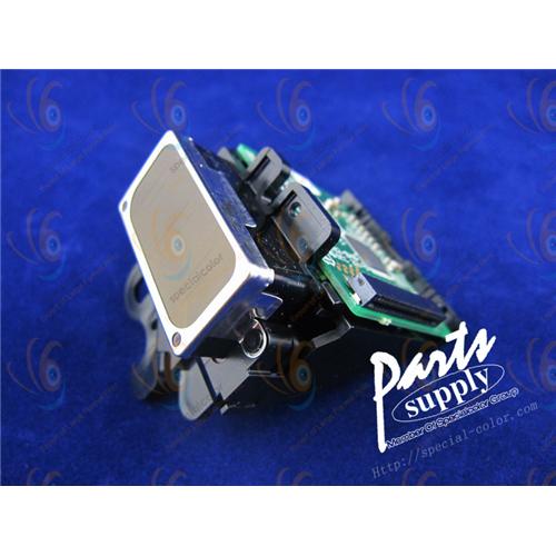

here are a DX3 and a DX2

I beg to differ.
http://ftp.epson.com/pdf/pro9k_/pro9k_sl.pdf
The Epson Stylus Pro 9000 was built by Mutoh and is basically the same platform as the Falcon Indoor 46. This is the ONLY literature from Epson that designates the head as a "DX" series. The DX3 has 3 channels of 128 nozzles per color.
The single-channel head in the Falcon Jr (which was used in the Epson Stylus COLOR 3000) is only called a "MicroPiezo" head by Epson and has 128 nozzles.
The so-called "DX4", "DX5", "DX6", and "DX7" heads are pure conjecture and Epson calls them something completely different. If you want to really identify the Epson model, the circuit boards are all marked with different model numbers.

What ever is in the Epson I have no clue." nor care" Here is what I know. I look up a new print head for a falcon outdoor and from all the stuff on signs 101 the Falcon outdoor has a dx2 head. I look up a dx2 and that's what I find. It works just fine. I look up dx3 and I see no heads that look like mine. Now if there is also a dx3 that looks like the one in my falcon great. Then I am would be wrong OR just maybe we are both right...

Sorry, I'm basically just being overly technical here.
Most people refer to the single-channel Falcon head as a DX2 for lack of any better reference. Epson only called it a MicroPiezo head.
The three-channel Falcon head is officially the MicroPiezo DX3.
The two-channel head used in most Falcon II, Mimaki and Roland printers is from the Epson 10000, and that one got nicknamed the DX4. Epson just called it a MicroPiezo head.
The eight-channel head used from everything from the Epson 4000 to the Mutoh ValueJet and every Chinese printer in between got nicknamed the DX5 since it was the "fifth generation" head. Epson called this one the MicroPiezo AMC.
The repackaged eight-channel head used in the GS6000 and new model Mutoh ValueJets is still called a MicroPiezo AMC by Epson. Mutoh calls it something entirely different. Everyone else calls it a DX6.
The latest Epson head, the 10-channel one used in the Stylus Pro 9900, is called the MicroPiezo AMC. Everyone else calls it a DX7.
Confusing enough?
