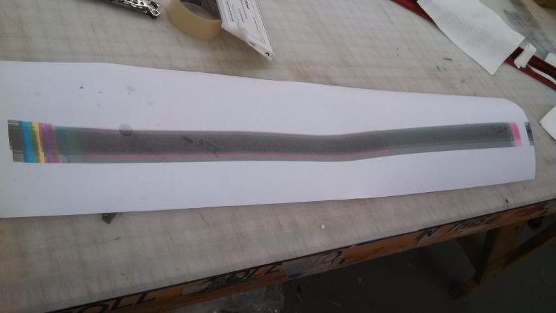

Huge problem, I think. Heres the bullet explanation
- Printer running fine yesterday
- Send a file today to print and spits out what is pictured below
- Machine powers off
- Upon power up, nothing happens, only flashing lights. No fans, nothing.
- Unplug the machine for 20 min, powers up, runs a cleaning cycle.
- Now NOTHING prints. The carriage moves back and forth but no ink is coming out.
Doing a head soak now, but how could I loose ALL of my head overnight?

Just popped the side cover off to see if ink was coming out during cleaning. It is, so clogged heads are out.
Looks like I'm chasing JHill's suggestion...

try cleaning the encoder strip with denatured alcohol, I am no technician, but when my encoder strip got some dirt and a splash on ink on it, its printing went crazy
--open the lid and its the grayish clear strip right in the middle its attached by black plastic clips and springs on each side.

As someone who just replaced the f2 fuse on my board, I can tell you this is a motherboard or head cable problem. Before pressing the power button, hold down the up, down, and right buttons....while holding all three down turn on the printer and wait for the printer to say 1. Platen Adj. This is the maintenance mode. Press the right arrow over to 2. and then press enter and scroll over to Head Signal. Move the printhead manually to the media... and then run ALL channels at 1,000x
It looks like a head signal test firing all the nozzles.
Signsforwhile
well just an update. GRS did come and fix the machine. A new board and head later and I'm up and running. Didn't start the week out thinking I was going to have to spend $4k on the printer, but on the upside it runs like it's brand new! I just need to keep in mind that our 1204 has run over 5 years nearly maintenance free and made us a good amount of money.

I cant speak about any other repairs done by other techs but below is what happened on this repair.
The motherboard was shot. The F2 fuse went, the network connection on the board went and there were other things going wrong with it.
We replaced the board and inspected the ribbon cables. The old head blew the F2 fuse on the new main board so we replaced the head and fuse. From that point on the unit worked.
