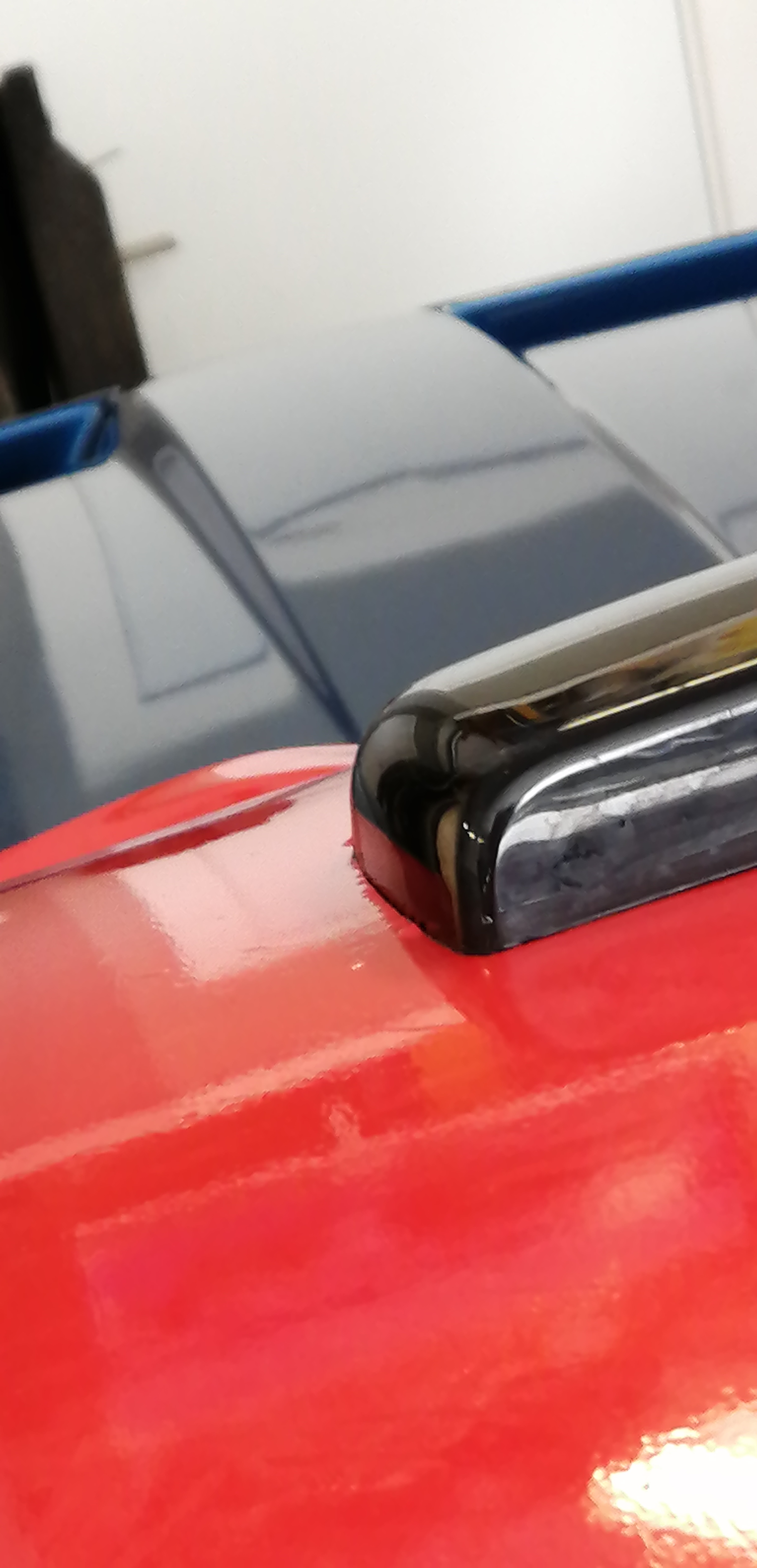

Hey crew, hope you're staying well.
Trying to identify the vinyl/installation issue with these little baby bacon wrinkles around this light. Any ideas on how to avoid this? Are we using the wrong vinyl (it's cast Avery) or the wrong technique, or both? Installer has dropped 3M Primer down around it but it just ain't staying down.
You cannot mix 3M primer with other vinyls. It has completely the opposite effect on other vinyls.

We would finesse it with a little heat and a good squeegee!
