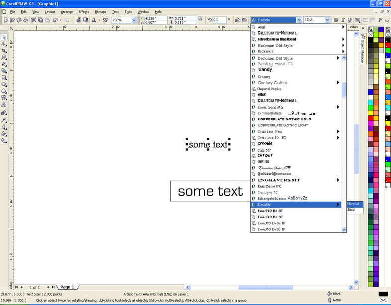

I have CS1 and I have the same "problem" as you...can't scroll through the font selection as there is no font dialogue box, everything is menu driven. If somebody could find the key to this little issue that would be great. It's these little things that make it difficult to make a commitment to Illustrator, or any other program, when you can just do it easier another way. Now that I think about it, you can't preview fonts on the fly with Omega either for installed fonts, only for Gerber fonts when working with the TOWS text tool. Usually if I need to preview fonts like that I use Bitstream Font Navigator, a feature that comes with Corel. That really does a good job as you can preview every font on your PC whether it's installed or not. In a pinch, I'll actually go over to Word and type it in there just because it allows previewing of installed fonts in the font dialogue box.....don't tell anybody though!
2NinerNiner2
No font preview is one of the main reasons that I never upgraded any of my Adobe products and why I never really got into AI that much, not knowing if they addressed this.
...this is one of the things I like about Corel... :)

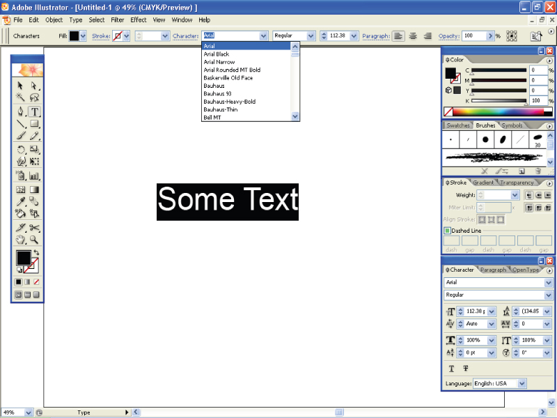

Rhino
I think what you are looking for is called "Control Palette".
In Illustrator: Click "Window" and make sure "Control Palette" has a check next to it.
Use the text tool, type some words, hi-light text (at the top of the screen you will see a place to change the font), click in the box to select a font, at that point you can scroll up and down with your keyboard and the font changes on your screen.
Is that what we are looking for??
:peace!:

Bob Gilliland
CS2 & CS3…not sure about CS as it’s been awhile:
  • Select text with Type tool
  • Single left click on the current font name
  • Scroll list using up or down arrow key to see preview
*** [CTRL+h] will hide the selection highlight that might make it easier to see the text as you scroll through the list. For the MAC users among us, that would be (CMND+H). Don't forget to toggle highlight back on, [CTRL+h], if you like seeing the highlight elsewhere in the program ***
*** Single left click on the font name is important. If you click on the drop down arrow, no go! At least from a “scrolling” perspective. ***
