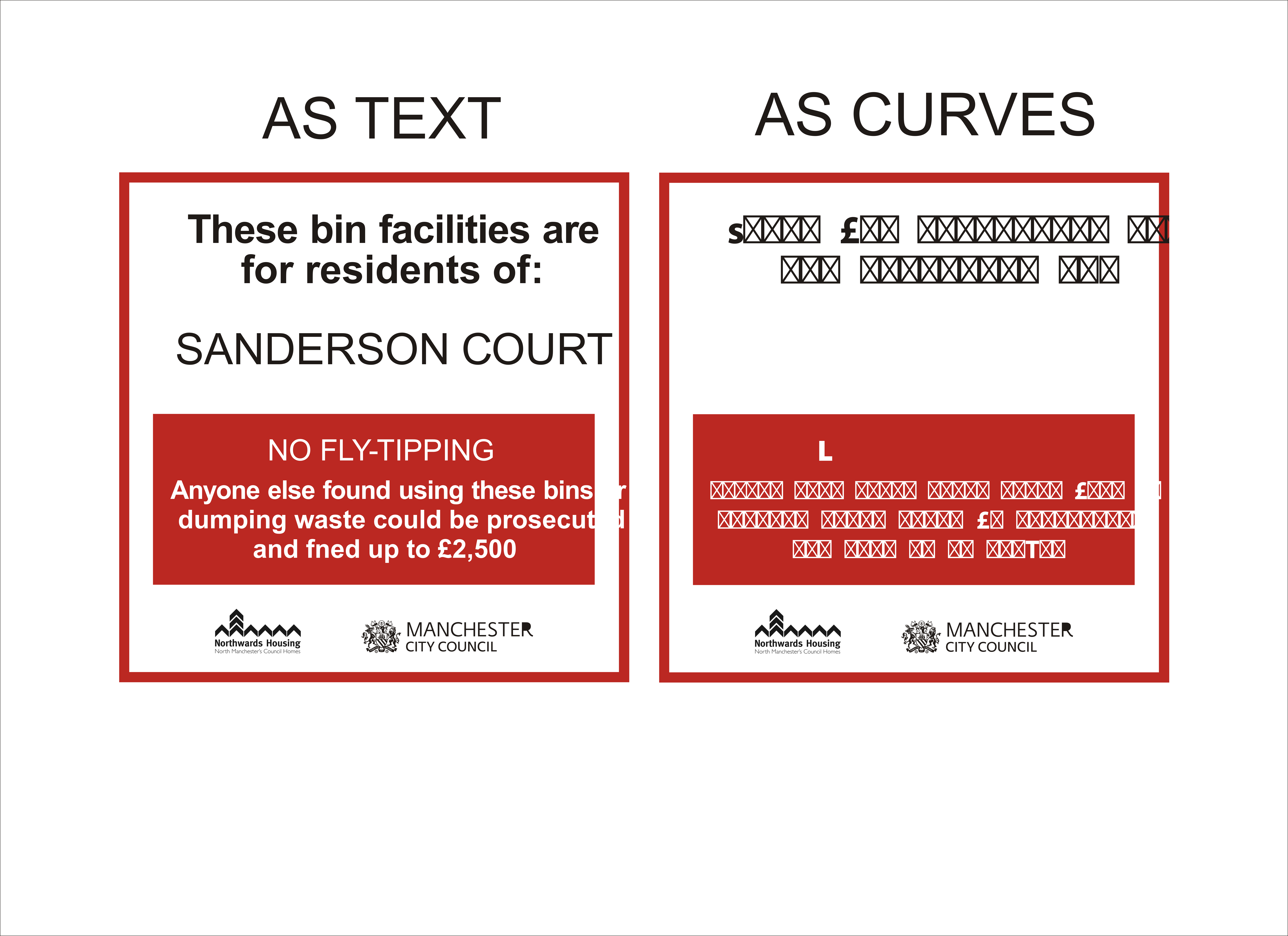

Good morning all, I have been sent a PDF file from one of my customers, a file that I have imported and printed off in the past without problems, everytime it has a different address on it.
This time if I open the PDF in Acrobat Reader, or Illustrator, or Omega Composer, the address is "The Smithfield Estate" which is what it should be.
However, if I import it into CorelDraw (version 2019 or X17) that name becomes "Sanderson Court"!!!!!
Doesn't matter if you open it with text as text or text as curves, makes no difference.
Can anyone else try opening this file and tell me if I'm seeing things?
Thank you :)

Seeing the same thing here in my old copy of Corel - X5.
Have not run into this before.
Must be some flag set that only Corel sees and sets.
Can you use the file from one of the programs that opens it correctly or it needs to be in Corel Draw for editing?

Thanks for trying, and yes I can get around it by retyping the name.
It's just so strange, never happened before! The funny thing is that the other name is a sign we've done a long time ago.
Whoever created the PDF in the first place must have replaced the name but somehow the PDF is hiding the old name.

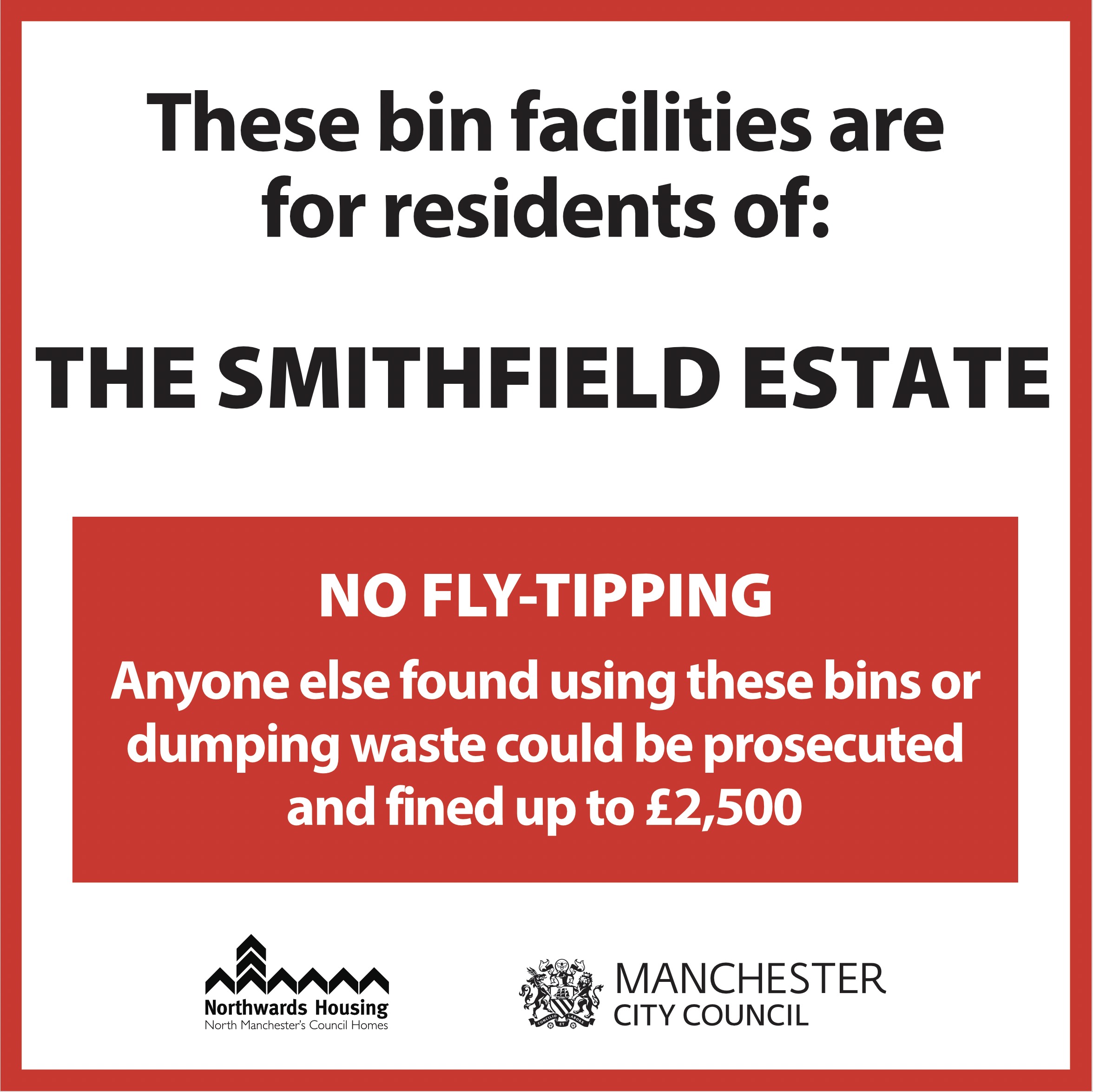

brycesteiner
It seems to open fine in Affinity Designer.
I don't even see hidden fields in it. I opened in Acrobat and tore it apart with Pitstop and there's nothing. I wonder if you found some kind of easter egg in Corel.

You're definitely missing a required font but I don't grasp how that rewrites the spelling.

I agree with JoeRees. The file come in for me (X7) using the correct fonts because I happened to have those. But it does change to a different address as explained. It is most bizarre and intriguing at the same time.
unclebun
When I import to Corel 2019 or open in AI, I get an error popup that says "Document contains fonts that have been reinterpreted."
JoeRees
I've never heard the word 'reinterpreted' before but it sure is a clue. So I googled it and found this suggestion to change the PDFs extension to .ai or .eps which seems to have worked...
Bizarrely, even with the missing font both the spelling and font displays correctly when imported as curves. No clue how that is possible.
