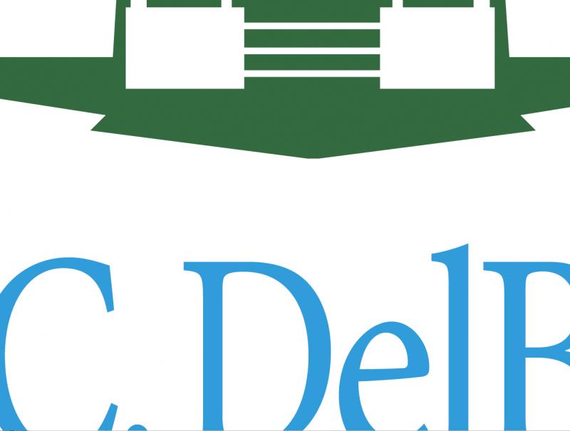

A member here is having a problem with a vector I sent to him. He said that his process is to import my ai into Corel and then copy/paste into LXI. Somewhere along the line the art is becoming rough. He said the curves in the letters are jagged and not smooth. I have not heard of this happening and I have converted thousands of files.
If I could get more than one of you to download and see if the letters are a problem. They should be nice smooth curves. Font used is adobe Minion
I believe he said it is already jagged in Corel
Please post your findings so I can find out if this is on my end or his
http://www.vectordoctor.com/delbuono agency.ai
GypsyGraphics
Don't own Corel but in Illustrator i get a clean, sharp vector file!

I tried importing it into corel, and it just shuts the program down.

Same as Stacy here, smooth and minimal points in illustrator.
I have seen some older versions of Corel exhibit similar tendencies... but I don't currently have Corel to check this for you.
njsigns
The file imports into X4 just fine, I suspect the issue is when copying and pasting into LXI - I also have a rebranded version of Flexi and I used to import .ai files (or .eps files UltraFlex wouldn't recognize) into CorelDraw X3 (and earlier) then copy and paste into UltraFlex - after a little while I noticed the curves weren't exactly smooth when I did this and it (from what I remember) generated many additional nodes. The problem I had (specifically) was I couldn't get UltraFlex to import any of the various vector formats I had available to export from CorelDraw or Illustrator. Then I started exporting from CorelDraw as a version 3.x illustrator file or a CorelDraw .cmx, which both import into UltraFlex just fine...

The windows clipboard is not the way to do it.
All the curves get turned into short 2 point lines.
The file opens fine in X3 with smooth curves - minimal nodes.
Copy to the clipboard and open in Flexi - lots of short line segments instead of curves.
The file will open directly in Flexi(7.6) without problems.
If he can get it into corel - exporting it out as a simple ai would be the right way to do it.

He needs to properly import and export his files. Cut and paste works sometimes but should be avoided.
cdiesel
The clipboard doesn't hold the vector data correctly.. He should take a lesson from OP and cut straight from Corel! ))))))))))))))))))))))
